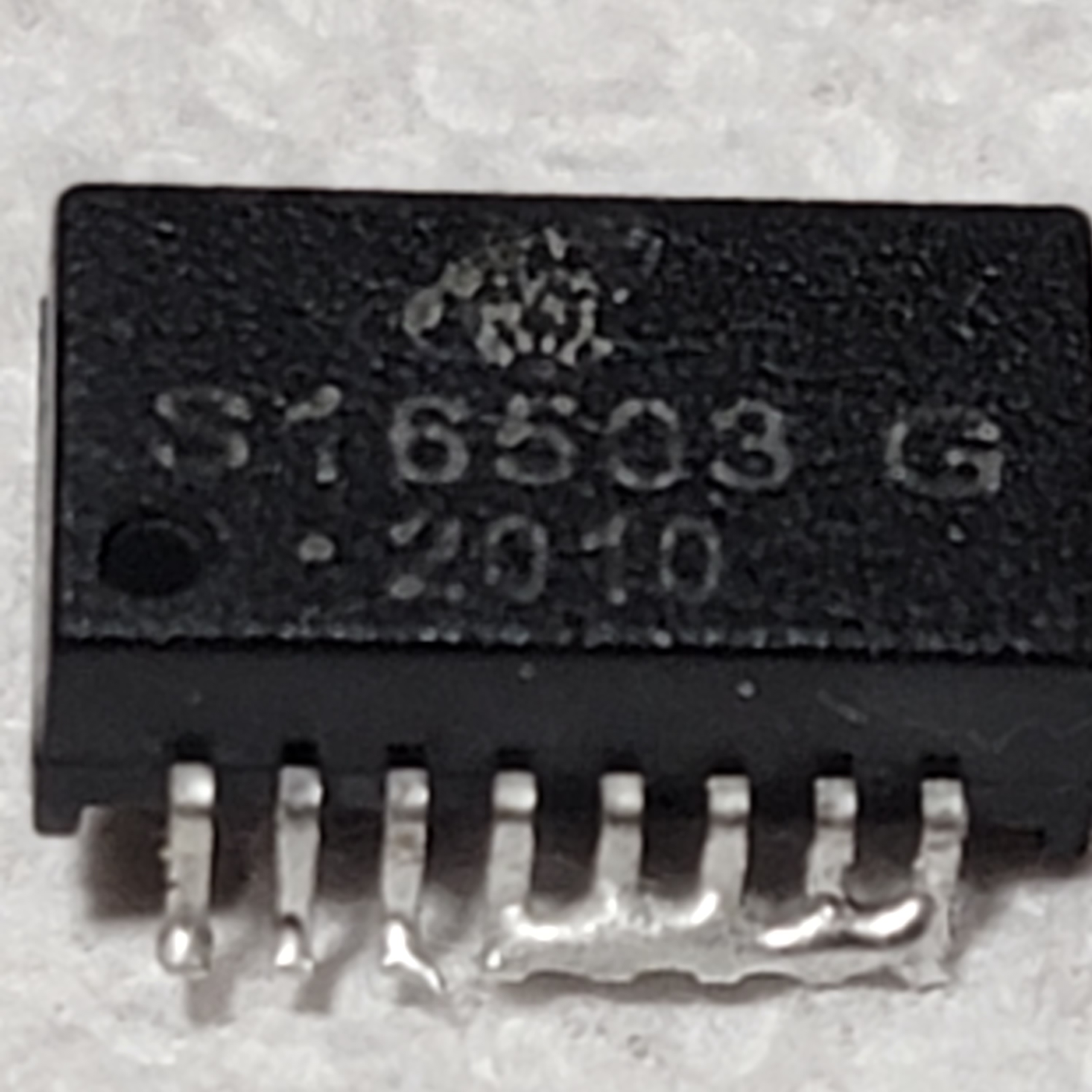

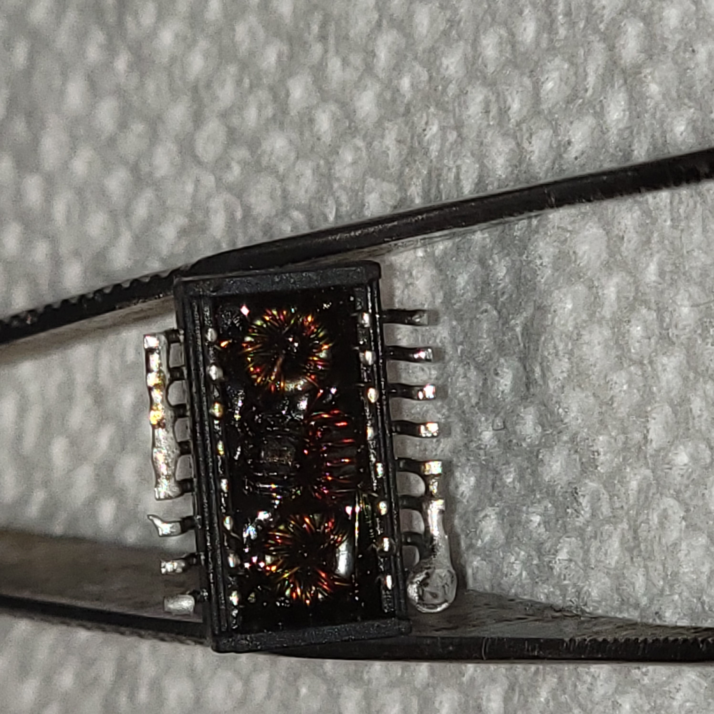

So last year in Jan I was working on a camera that I removed a damaged Transformer and took a picture of it. This is a common part number however it isn't the only one that I have come across while making repairs of these types.. The under side picture you can see the center is black it should be the same color as the other 2 sides and because of the damaged part the POE of the camera would work but the camera data couldn't pass. I have had some that the damage was much worse then this and no data and no POE.. So it isn't always the same.. That is a common issue. However not always the problem with dead cameras.. In some cases the camera are cheap enough they are not worth repairing. However this camera was a PTZ AI camera and cost to repair over buying new required the repair..

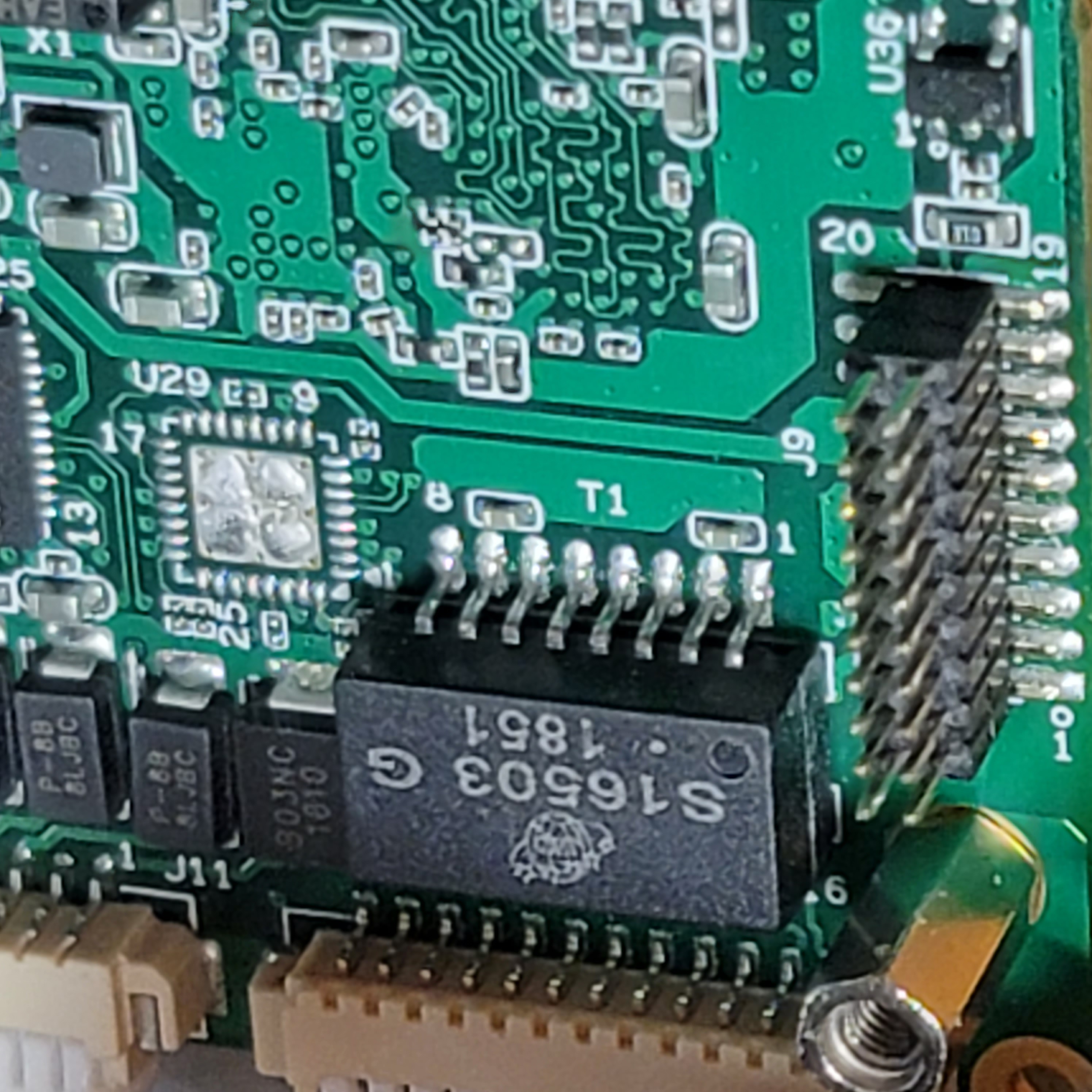

On another repair last year Feb or march. This is from a Dahua Zoom Ai Bullet camera that was just under 400 when new. You can see it is an older chip because the camera is older with a date code of 51 week of 2018 where the first pictures the part is from 10 week of 2020..
