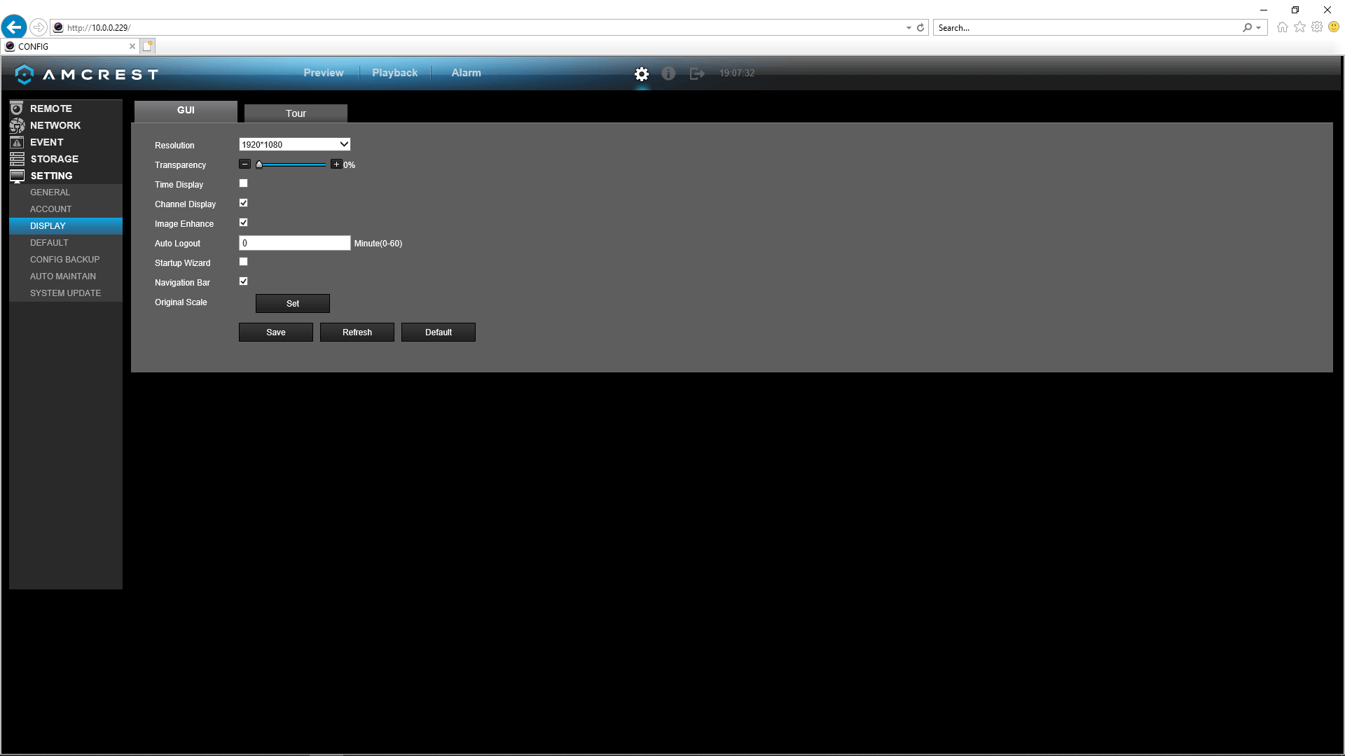

You can log into the IP address for your NVR over IE and then once you log on you can add your cameras into your view but if you want to make the change to lower Res you would click on the COG wheel looking thing at the top of the window. Then click on Setting this Display and make the change there.. Here is a Picture of my 4108
Screenshot (1211).png (74.04 KiB) Viewed 4811 times
