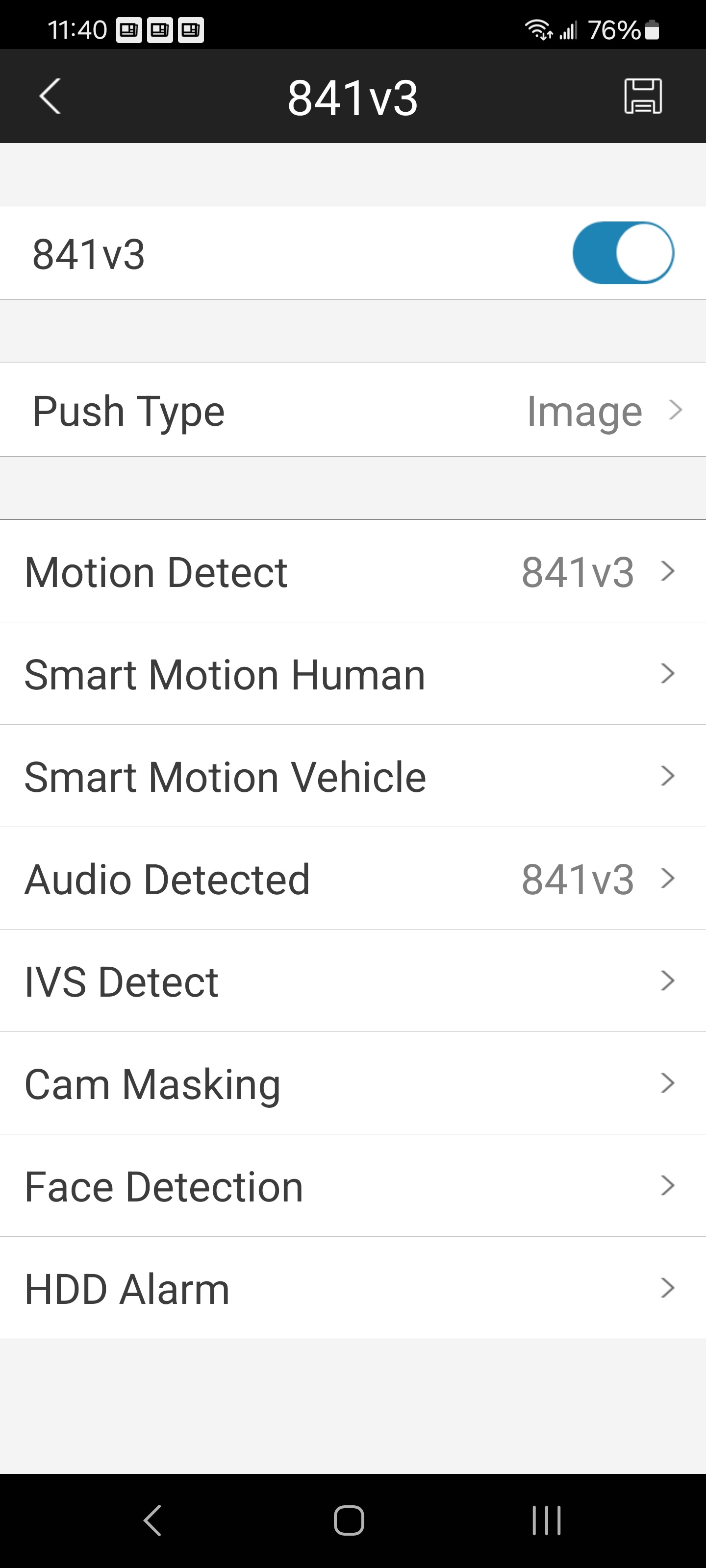

Next when you setup the device to your phone it won't normally give you notices until you setup the device to do so. Now you said that your device is recording events and able to place back. So now using AVP (Amcrest View Pro) bring up the device in the list, Then while in the view mode at the top left click on the 3 dots with 3 lines. Now you will want to go to Push Notices. Click that, then you will want to setup how it will give you the notices, You said Motion, so pick that then what type of event do you want. Live, Image or Video. Personally I choose Image and it will play out like a video in motion image format. This is the fastest way. If you think about it from Alert to Notice event times if you setup to do Video that video will have to be recorded and then it will send the notice. With Images it will alert you and the images will be recording as you are being alerted. So that is the fastest way. Also in the event that it does send Video you might be alerted sooner then when done however in that mode if you go and want to play it back before it has ended then you will get a message that there is no recording. So Image is best for me.
Screenshot_20231211_234058_Amcrest View Pro.jpg (287.02 KiB) Viewed 19684 times
Re: Notification Android Samsun Galaxy S23
Oh sorry forgot to mention also. When you setup like the picture above. Be sure to save by clicking the Disk looking icon top right to save the changes.

OK.....I changed my setting from Live view to "Image" and that seems to have worked. I am not sure why I didn't realize that I had set on "Live View" to being with. Thank you for the help....I am sure I will have more questions.
