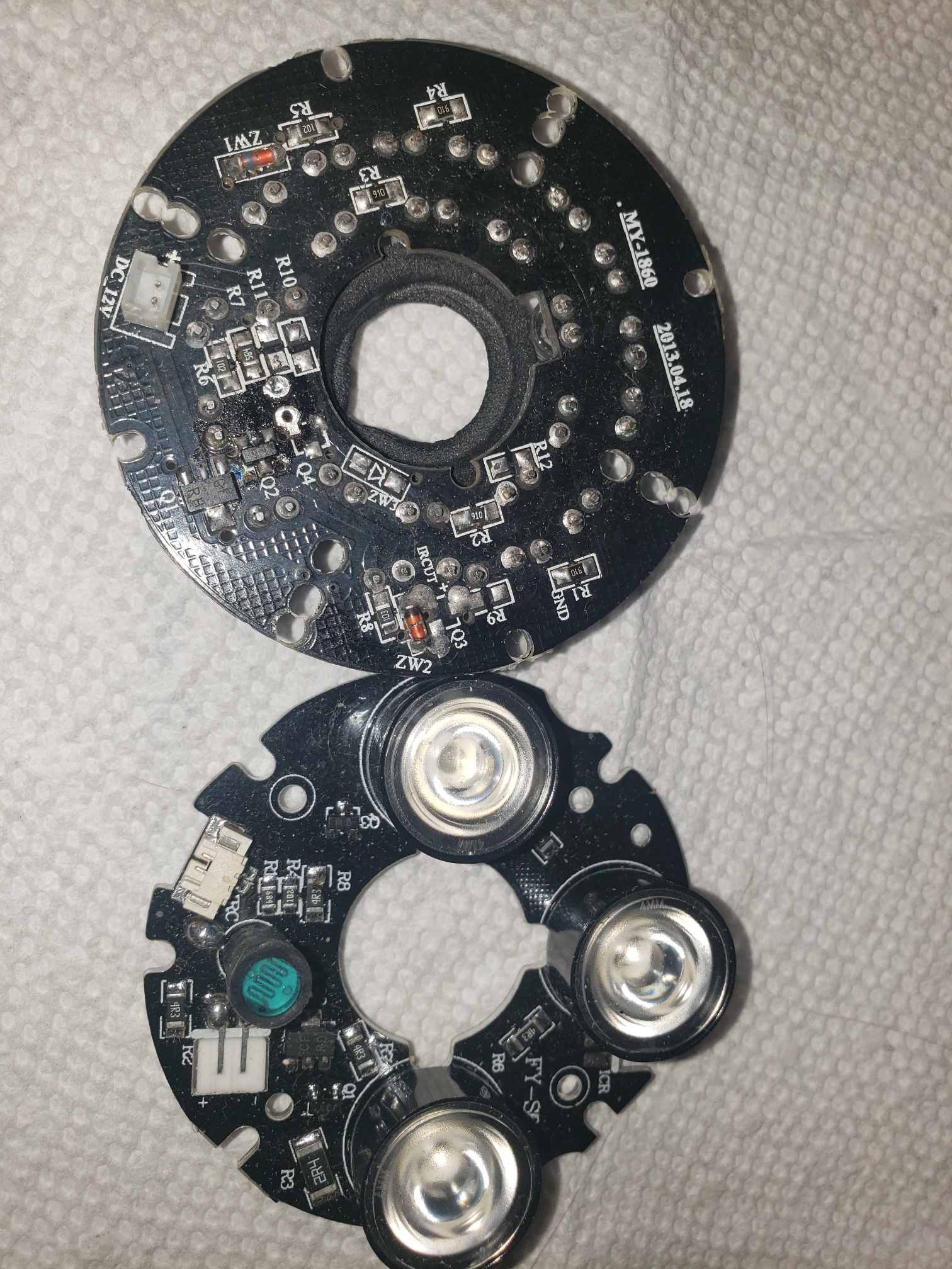

So sadly the next issue isn't something that everyone can do but over time IR fails and from what it sounds like in your post if a Known Good Power supply won't work the camera alone then we can root out the issue being a bad Power supply this only leads me to one last thing and that is a Bad IR board.. While the whole board might not be the issue it could be that the IR LED has shorted and is causing the camera to shut down in a way to preserve itself.. So what could you do? (Again not everyone has been in Electronics for 40 years) however if you were able to you could remove the front of the camera, My system came with 2 bullet and 2 Eyeball cameras, So not sure what one of your is bad or if your is different however the Bullet one of mine has 4 screws on the front that hold the glass on, Removing the 4 screws from front, then the 3 or 4 in side holding down the IR board unless your able to remove the wires without pulling the board out.. The Eyeball camera is easier to take apart as there is no screws holding it together just have to unscrew the front lens half off the back camera holding half and gain access to the IR board again there will be 2 wires and depending on the type of 960h cameras you have it might also have a IRC wire as well.....
Please make NOTE... Removing the IR from the camera will make the camera stay in Color at night, While you can replace the IR LED if you can find what one is bad and or it could be the Power Supply if yours has one and not just the wire connecter.. While looking at the IR Board you would know if it has power Circuit if there is more then just LEDs and little SMD resistors, There might be some diodes, transistors and other things within the IR circuit board.. If only IR leds and a few resistors then more then likely the IR led has failed causing your camera to shut off when IR comes on or is told to..
Re: Nothing but trouble with the night vision (video loss)
Here is an LED that I need to replace myself.. Right now the one that you can't see the LEDs on are different LEDs however I am replacing it with the 3 lED one for the time being while I wait for my LDR's to get to me.. This IR is out of an OLDER 2014 camera that has LED board that was built in 2013.. Camera still works and the one it was removed from only has 1 connector for power where the one that I am replacing it with has power and the IRC connector and designed for a better camera.. This camera while it does have IR at night it don't have a IRC so the Filter is a dual color glass that sits infront of the Camera Sensor where the 3 LED one will work with some of my other cameras with IRC that at night will cause the Filter to change places so the IR LED can work at night and show the right color.. These 2 boards have power Circuit on the board as you can see by all the little SMD parts
