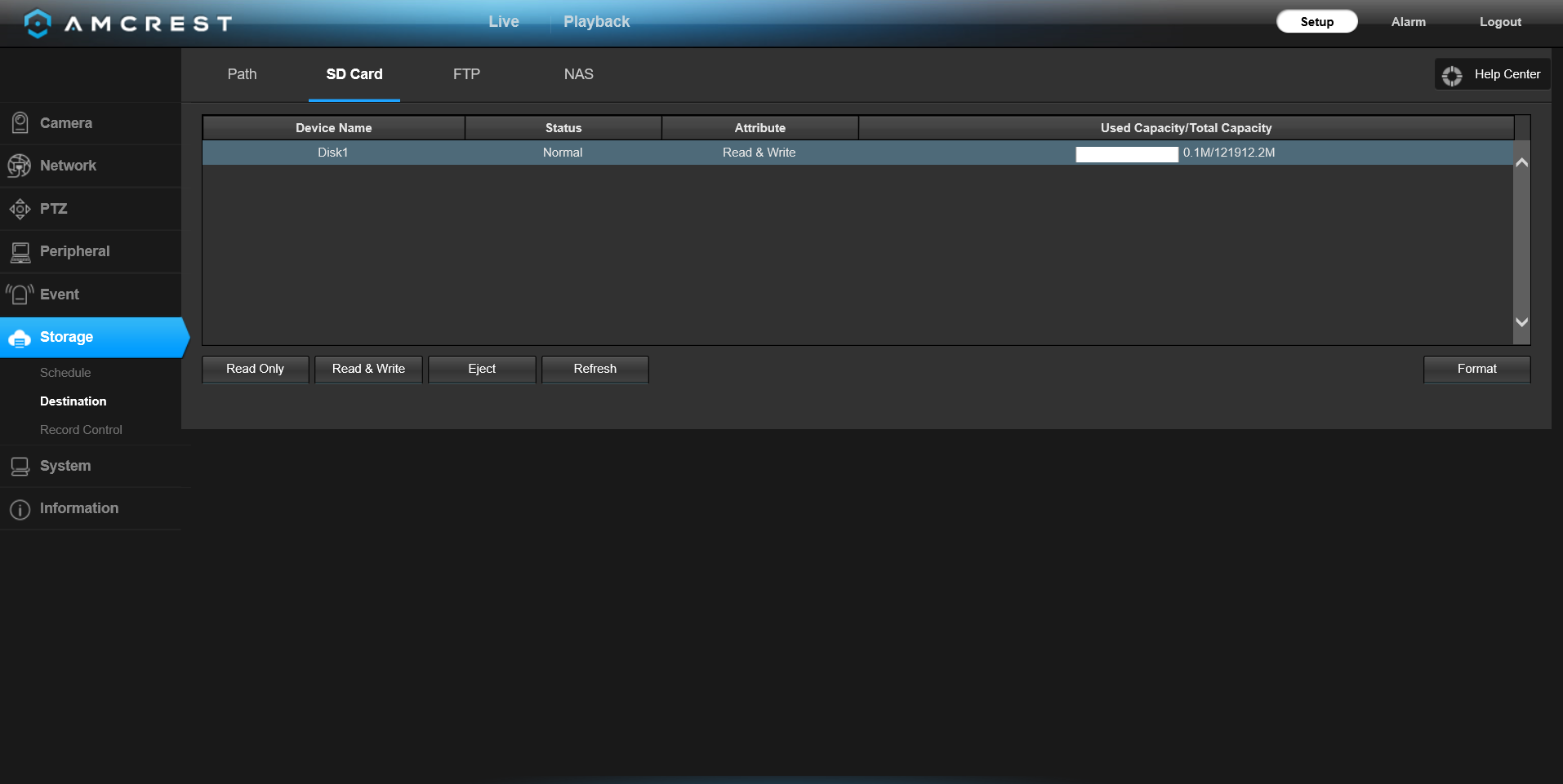

Hello all, So I have my system setup to record on my DVR and NVR and the ones that I feel are important I try to make sure I have enough backup footage that I am covered if ever needed.. Today the issue is working with my 850EB it was working on a 64gb MSD and wanted to move the camera from its location to a different one that will get more motion so I thought I would install the Max MSD I could so Installed a WD Purple 128gb.. If you have a 850EB then you know access to the MSD while can be easy to get to the board it isn't easy to install or remove the MSD.. So taking it in and out isn't fun.. So it installed and has been formatted and shows it should be working however now the files are no longer being saved and the NVR is acting like there is a MSD error and is on a Constant Recording even though I have it setup for Motion.. I have Rebooted the Camera as well.
Looking for any one that has had some issues like this and what was the cure.. To be honest the 64gb card while is an older card it still was working without an issue so if I have to size down I can still do that.. Both cards are a Western Digital Purple card so I know it isn't the brand being used..
Not recording on MSD
Re: Not recording on MSD
So after setting the record for Full time recording it has recorded without an issue. So I will just keep an eye on things and see what is going on. Also found that the Icon on the NVR was caused by me changing all my Sub Streams from off to Manual and isn't recording unless instructed so things are working as expected or I guess better then expected seeing it isn't picking up birds or things outside the zone like the camera I replaced with this one..
