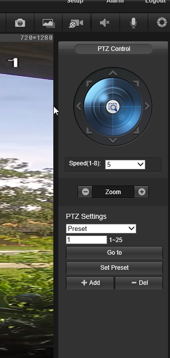

I can see the Add button, but when i click on it, nothing happens; I can't add presets to this.
Any idea why?

- 2020-07-15 15_17_10-Live - Internet Explorer.png (167.41 KiB) Viewed 2089 times

So that is the area for adding presets and I can tell you while you don't see it does anything I can tell you that you press teh +Add button and change 1 to 25 you will add a preset..
So take your camera move to area you want change number to 2 press the +Add and then move the camera with the arrow keys to another area on screen then click the Go to and you will go back to where the 2 was set.. sadly there is no Preset naming or preset Picture setup for Presets...

I've recently come across a similar issue ( maybe the same ) with the IP66, 4MP, IP4M-1053EW. I too, have no "add preset" buttons in the areas shown above.
I'm on a much newer version: Build Date: 2020-04-21, but in order for me to add presets I had to click Setup > PTZ > Function.
Agreed, all the videos and documentation I've found appear to be dated ( at best ).Hope this helps.

ARGH! I believe it is a bug in the camera's firmware. The workaround is to change the scale factor in your windows display settings. In my case when I changed it from 150% to 125%, and refreshed the browser, I could see the Set/Add/Del buttons. They must be cropped out of existence for certain display configurations. If anyone is paying attention to a new reply to a 4 year old thread, I can post some screen shots to show the problem and the workaround.
