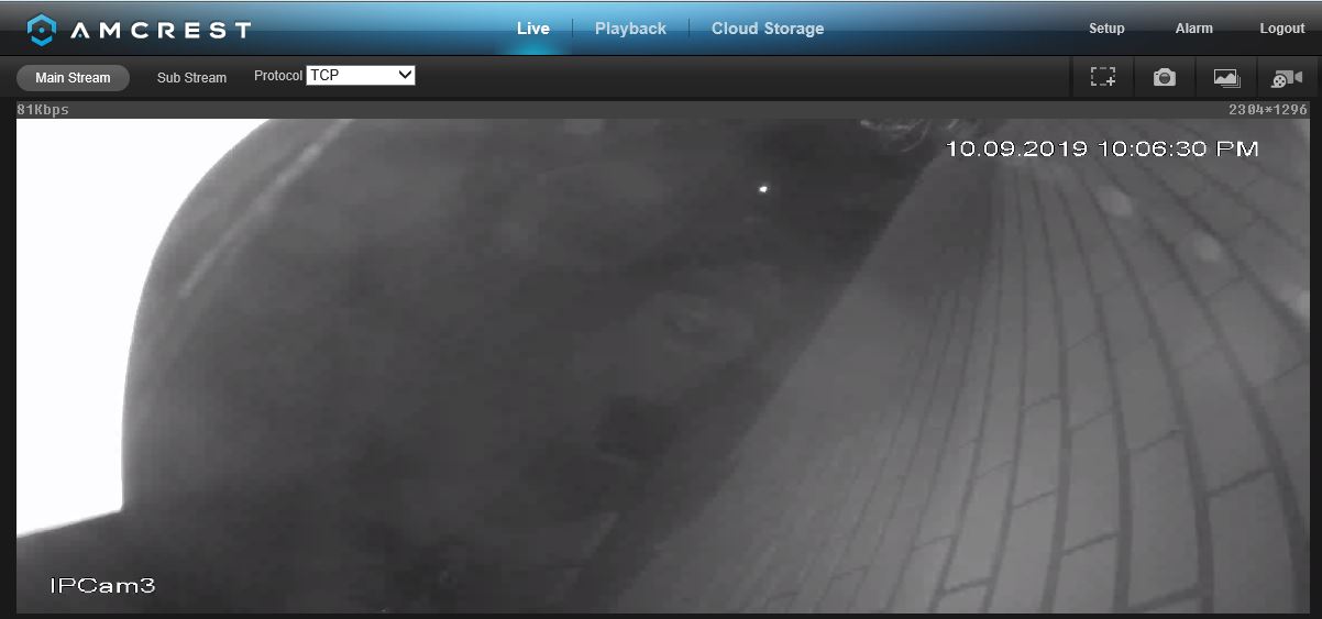

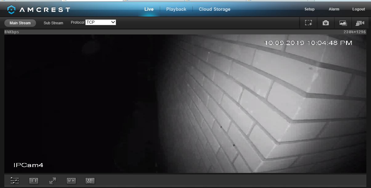

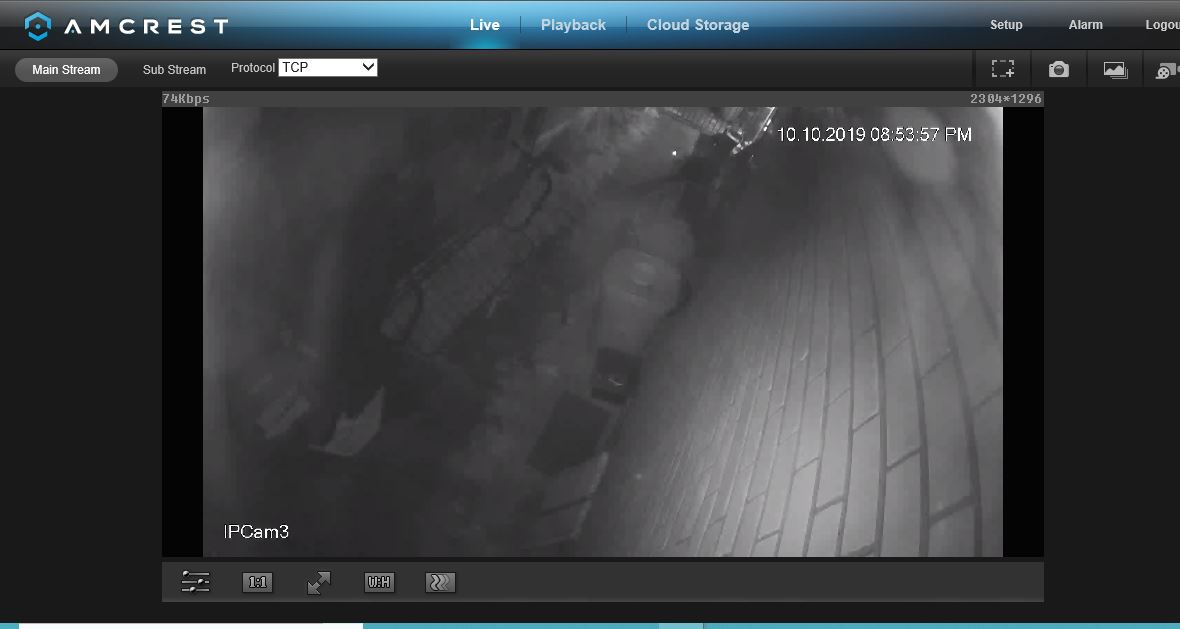

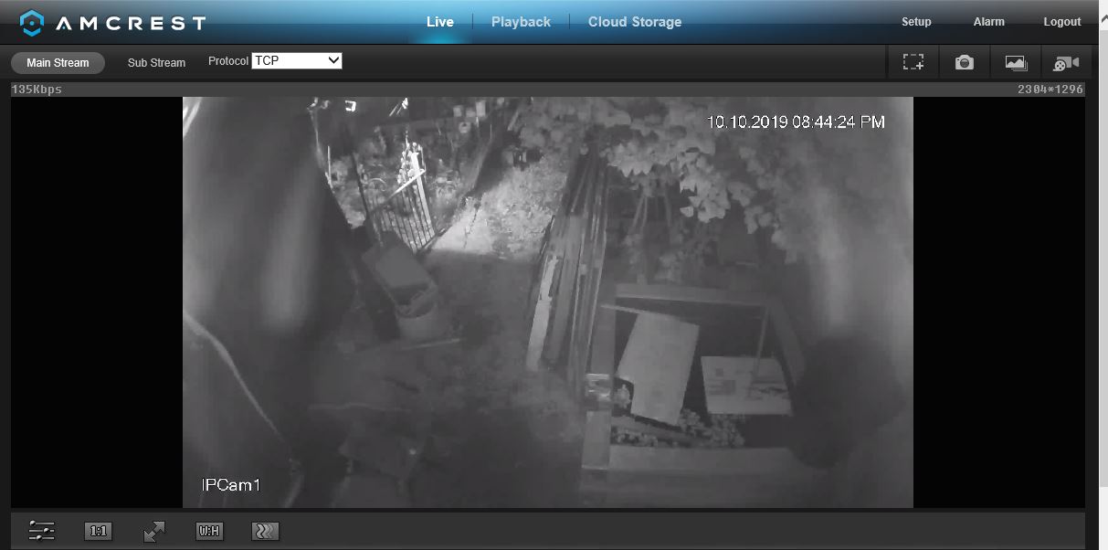

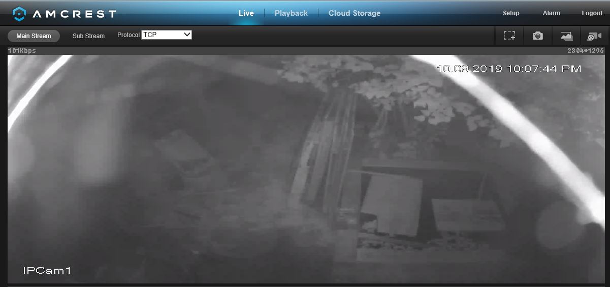

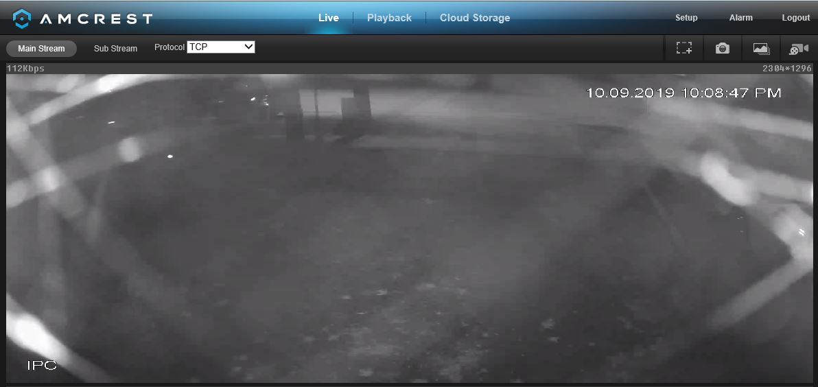

More information - cams are not a year old yet. I am including pic from screen shots.
I have set cams back to settings defaults. I took the screen shots after.

Ok so I am going to guess here as I can't see what is really going on. But it looks like you need to do some Lens Maintenance or move the cameras away from the Windows they are looking out?
Soft cloth like one you would clean your glasses with and wipe off the lens if they are outdoors and covered in water spot and cobwebs. That is for the 3 bottom cameras.
Top camera looks good besides the settings are in need of adjustment. Or the camera needs to move away from the wall. Almost looks like IR LEDS our out in the first one. However try this for the first one... Under your BLC check and try WDR if your camera has it, Try BLC under normal may have it set Custom now and that is why it looks like that... I have mine set under HLC for the best picture for my camera.
IPCam3 almost looks like it is in a window looking out. IR wash back. THen it also looks like Tunnel effect because it is in corner that has to much Reflections and seeing the lens is round it highlights that fact. The others really look like webs are infront of lens or Glass is fractured

Ok so looking at your pictures your IR are on. Your running your cameras in Night mode at night, Smart IR set and might want to try manual.
For the camera that is really close to the Wall Ipcam4 to be Honest if that is where you need it placed would Benefit from a IR Blaster. Then what would happen with your system under Smart IR the camera most likely wouldn't use the IR in the camera only the Blaster because it would offer the best light and camera while being B/W would be able to see almost perfect. However cheap IR Blasters may give some use but may not last as long as a PRO sytem would. They would almost look like a camera some are wider some longer but will make the area away from wall more the focal point. It almost looks like your camera is pointing to close to to the wall.

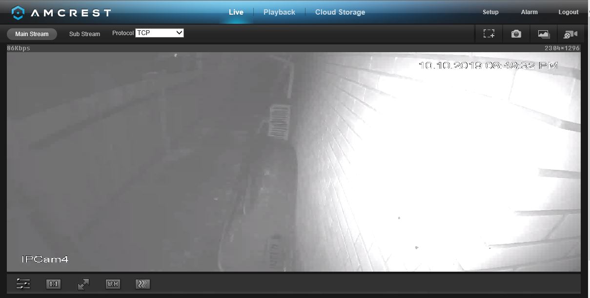

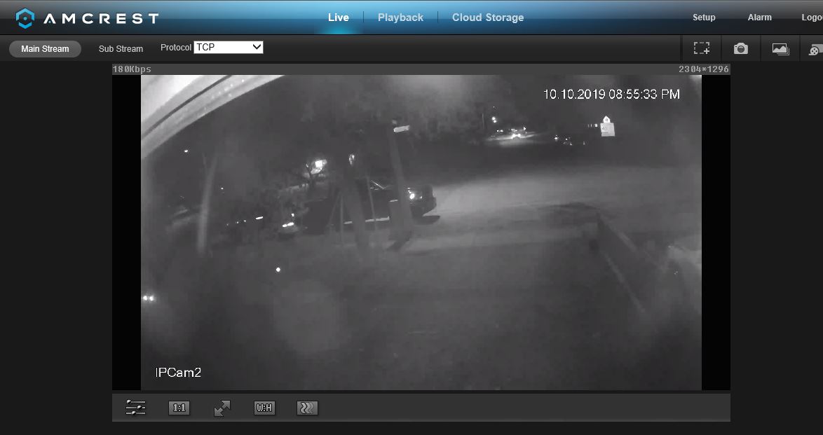

Cleaning the surface glass seems to have improved view somewhat.Lens Maintenance
I have repositioned Cam4 and tried to adjust the picture in Setup >Camera config> Picture and as you can see by screenshot I can at least see the alleyway now.move the cameras
yes that seems to improve view when WDR instead of BLC.Under your BLC check and try WDR

It is a really good improvement I would say that a Good IR Blaster would be a good start for your camera 4 sadly it seems that the cameras Focal point is on the wall more then the alley. I am going to guess to try and keep the image in your own yard. However to be honest I would just adjust the camera and set up a Mask to the left side to keep out what you don't want to see. This way your FOV and IR are not blasting your wall.....
So to get to setup press the setup on the top right and then it iwll come up with Camera, Then configuration. in there is where you can get the BLC MODE. In there you can set what fits your needs. Grainy pictures can happen. HLC would be a good setting if you have White LIGHT setup. The company that I have some of my IR from sale both White light and IR I have both. However today I am not sure I would Invest in the hardware from there. Might be able to find some on the E ### website however I am sure they would be stil couple hundred where when I bought they were 410 to 1550 depending on what you needed. I would say even some of the lower quality ones today out there would work however might not give life of these with Warranty of 5 years and Life of 10yrs. Sadly mine started to fail around 8 years however found out that they had been on full time because the sensors went bad... It happens...
