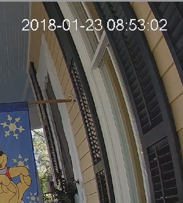

I am hoping someone can tell me what my issue is here...but I have a new 4mp outdoor wifi camera (IP4-1026W).
When watching the live view the time stamp jumps around...i.e. it doesn't go sequentially : 01,02,03....it goes like 02,06,15,21...
So, I am missing certain live footage for sure when watching....I have not verified if I am missing recorded data because my micro-sd has not arrived.
Is this due to "wifi" strength?
This is new to me, but does the 4mp affect watching it?
Note: I do have another camera (indoor) that does not jump around..its a 2mp camera.
I did a speed check on my internet and am receiving 29-34mb download speed.
Again, a newbie and really need some help here....I am an I.T. guy so anything you recommend I can

update: I just noticed on my phone the LIVE VIEW timestamp is not jumping around...but it is with Amcrest Surveillance Pro on my desktop at work...typically its the other way around.

Once I installed the camera up on the post (had it sitting on a table in this post), all cleared up. Waiting on micro-sd to see if records during the time jumps. I used a free app DR. WIFI to check wifi on my porch before installing. My app on phone was working well. go figure.
