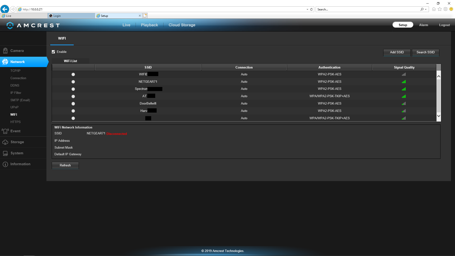

So a SSID stands for Service Set Id, This is the ID of your wifi. My guess was that was how it was connected seeing you were saying your cameras are not connecting and that normally would be because the Wifi you were connected to is no longer around. So when you go to your camera. In my picture below you can see what SSID I had my camera connected to, I have it connected right now to a Ethernet cable so I have disabled the Wifi of the camera right now.
However as you can see in the list in my picture it will show all the SSID that is in reach and if you don't remember yours then you can just on that page of your camera setup to the current SSID, you will just have to add in the password for the connection..
however in my case, my SSID didn't come default as this. So if say I was to reset the router back to factory, I would have to change the SSID and password back to what I have it setup for now and doing so will let all the devices I have setup using wifi to connect without any intervention from the camera it self. If you have others that have used your Wifi in the past and you don't want them to have access anymore then keep the SSID in your router as it came and log into your cameras and setup new Wifi SSID and password...
