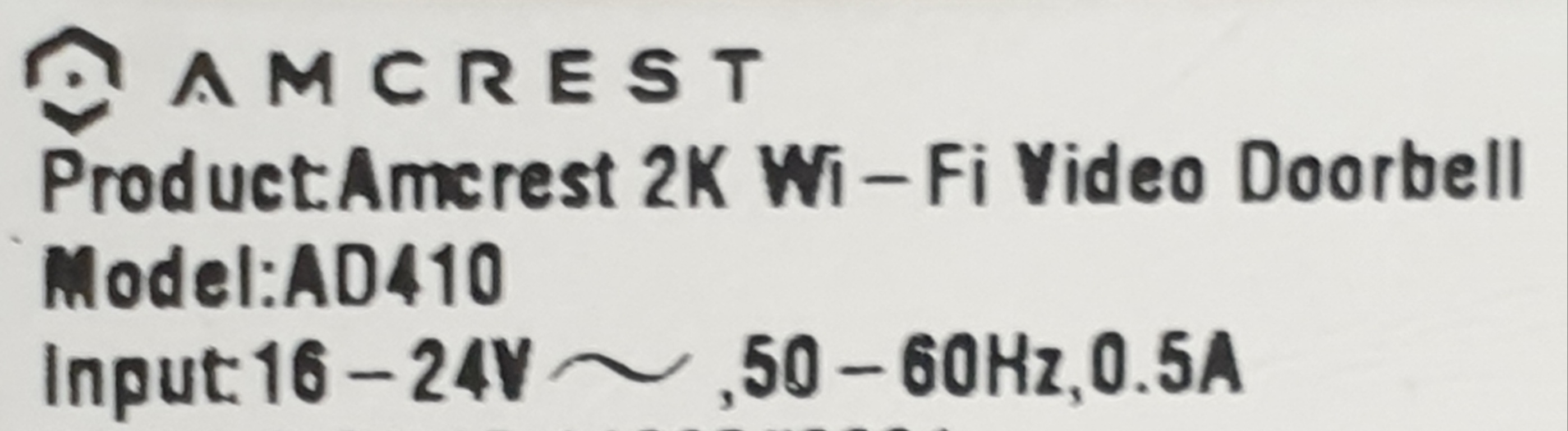

I don't understand, on the back of the doorbell it clearly says 16- 24 volts 0.5 amps. So where does the 2 amps come from?
- 20210719_105322.jpg (248.43 KiB) Viewed 10577 times

2amps is the max that your Power supply says it can produce and that is at 12vac. So that was where my 2 amp info comes from.
