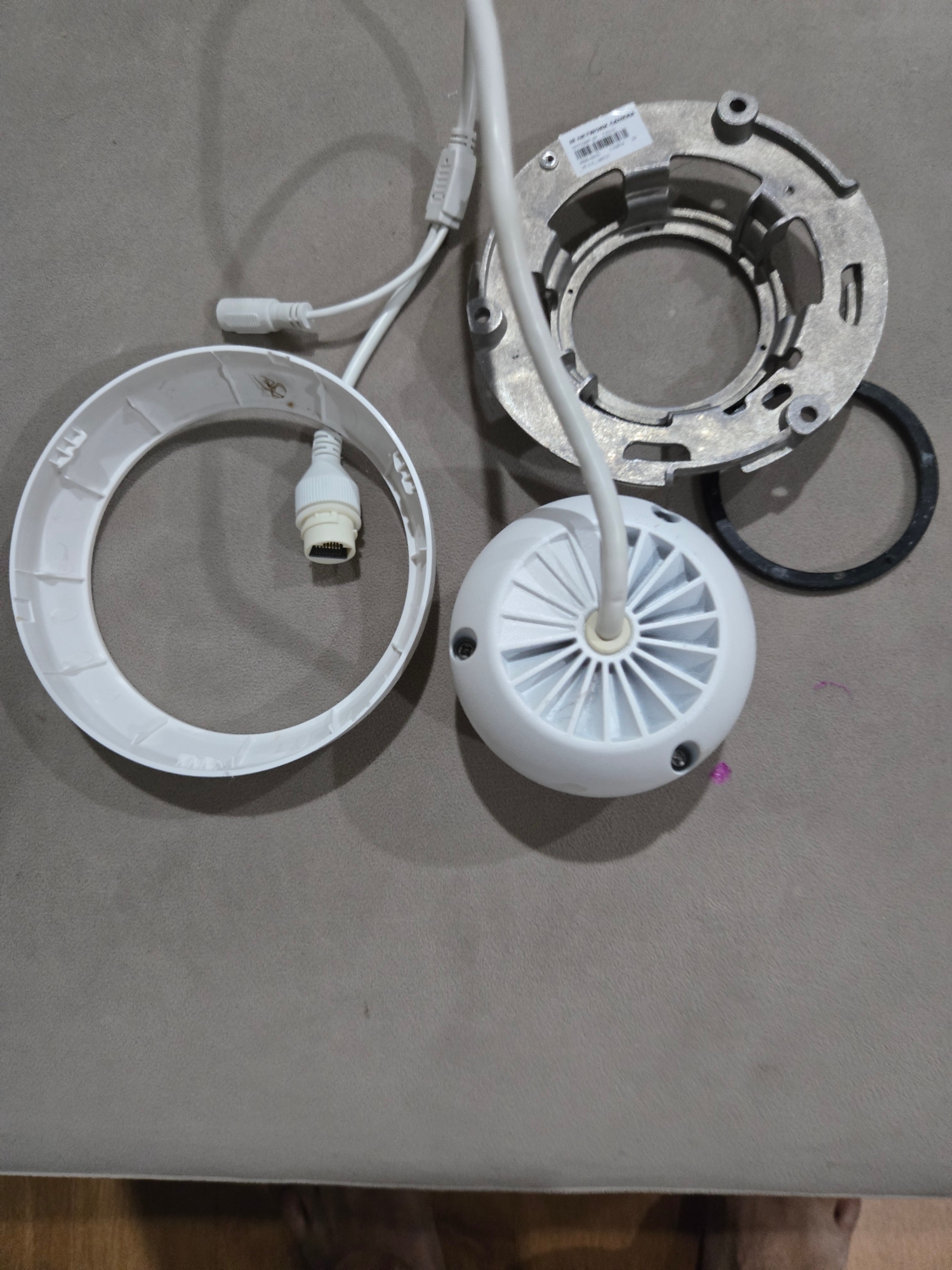

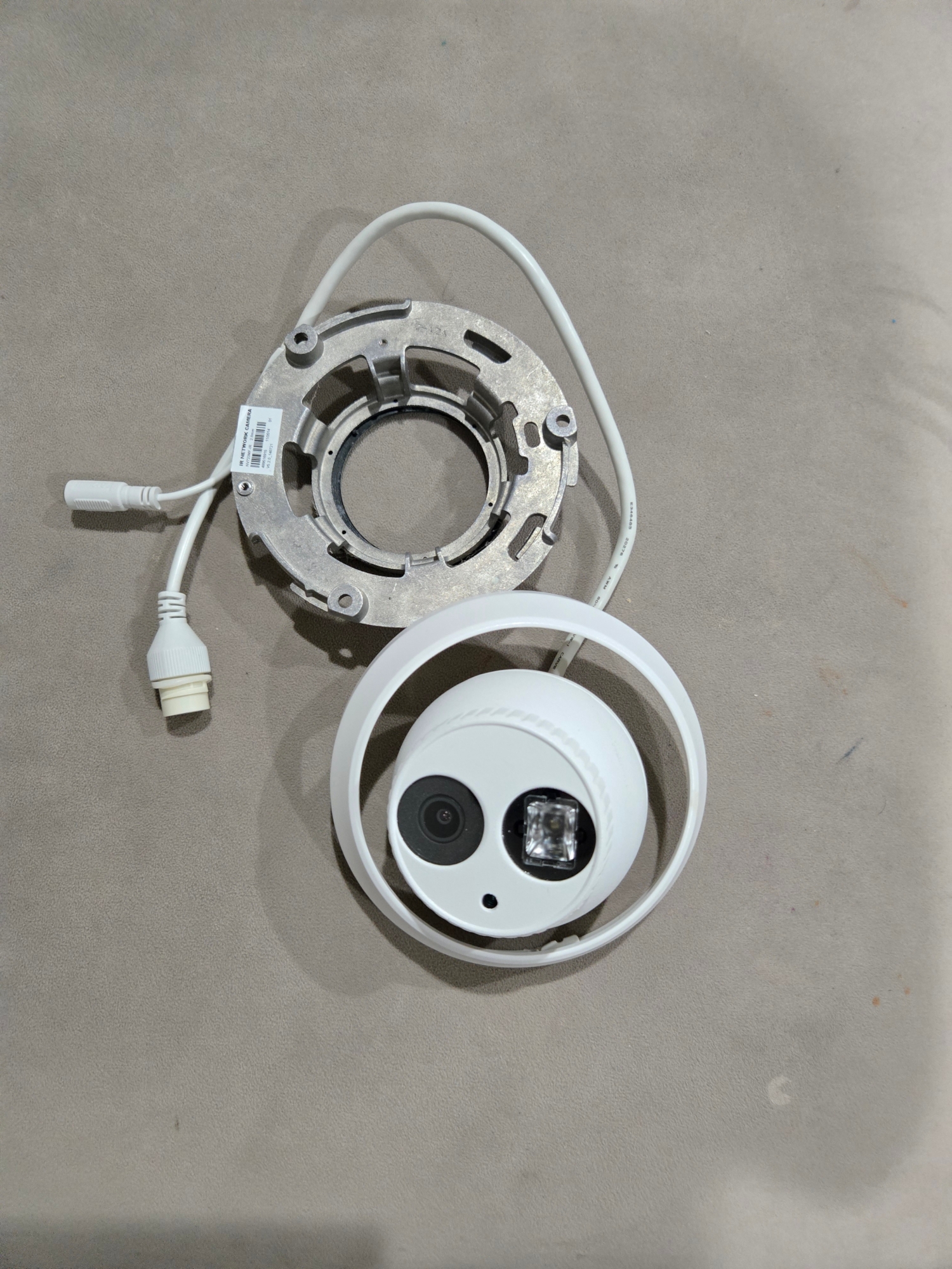

Recently moved to a new home with Amcrest NVR ( Model nv 4116-hs) and around 8 camera's installed.
All cameras are POE as I have located the POE switch.
I can see that all cameras are working too as they show the infrared light turn on in the dark.
However, only 1 camera showing up in the NVR and it works.
None of the remaining 7 cameras is showing up in the nvr.
I removed one camera but have no idea what model or make of the camera is.
I am attaching the pic of the camera here.
I am looking for help
1- How to make all the cameras show up in the nvr
2- what make is this camera

On that Sticker it don't say what model it is?? it does kind of look like a many different offerings.. Right out the gate I am going to guess it is a 1179..

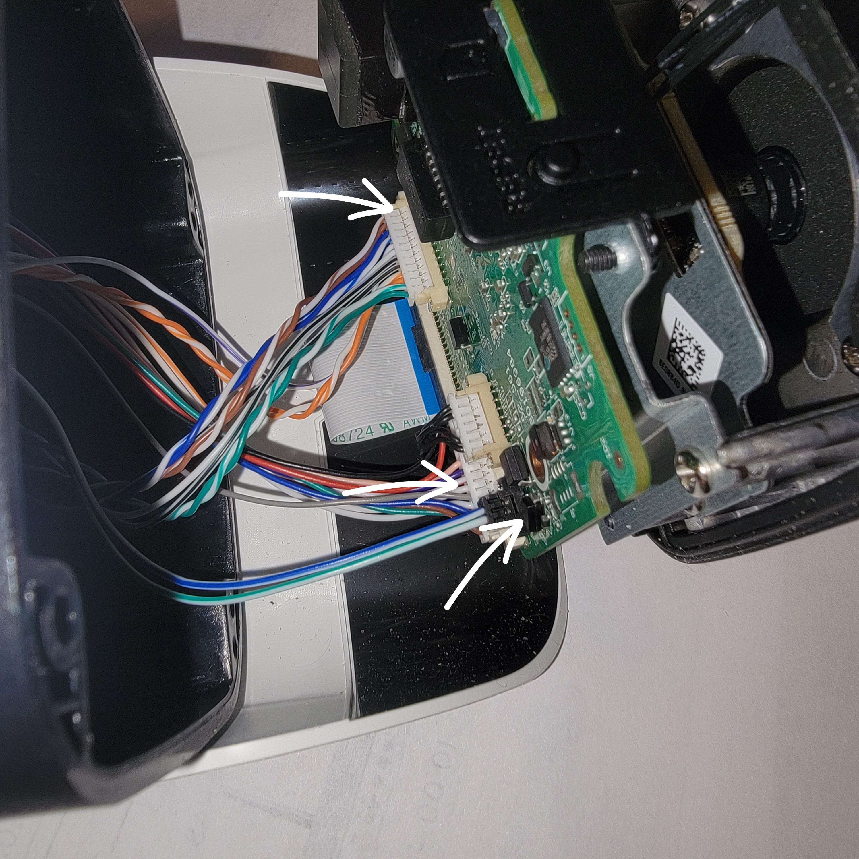

So I will walk you through what needs to happen now.. One of the cameras that you took down will need to be taken apart, Once you get the 2 parts and expose the inside you will want to look at the wiring where it connects to the PCB. Seen a Youtube video where someone did that, cut off all the extra wires to an Amcrest POE AI camera and IRKED me.. Anyway you will want to remove the connecter from the PCB. The camera should have normal 8 wires for the ethernet connection and maybe only 4 but if there is the normal wiring color inside the camera for ethernet, orange, green, blue and brown with the respective white then the other wires in the connector would be power and what ever elese they might have had.. One would need to know for sure what wires come in the bundle. Like some of my Amcrest cameras have the Ethernet, power, alarm, audio. Then aother camera I own that does have reset on the wire as well has all that I just stated with the reset pair and also has an BNC video output.. Normally when there is many different wires on the bundle there will be 2 or more connectors in the PCB even have one that power pair inside on their own..
Anyway once you were to take camera apart, find the wires went to what then it would be as simple as shorting the 2 wires at the PCB connector to reset the camera.. Also to make it easier for the future and if you had the area in the camera, Like some of my cameras have nice deep area, you could cut the wire before it exits the camera body and solder a micro push button on to the 2 wires and hot glue or epoxy the switch to the inside for easy resetting in the future..

Re: Need help with Cameras not showing up NVR and Which is this camera ?
So looking at this picture I put arrows where the wire connects to pcb from outside, you can see a connector with only black wires that on this camera is power wires to camera pcb and not incoming wires. On this camera it has ethernet, alarm in and out, power wires, audio in and out and the 2 wires by itself is 12v output for powering the Mic and might be how a camera with reset button on wiring bundle might be if not it should be easy enough to figure out what pair is for reset. My reset on this camera is on the black plastic access from port on outside but wanted to show what I was talking about.
