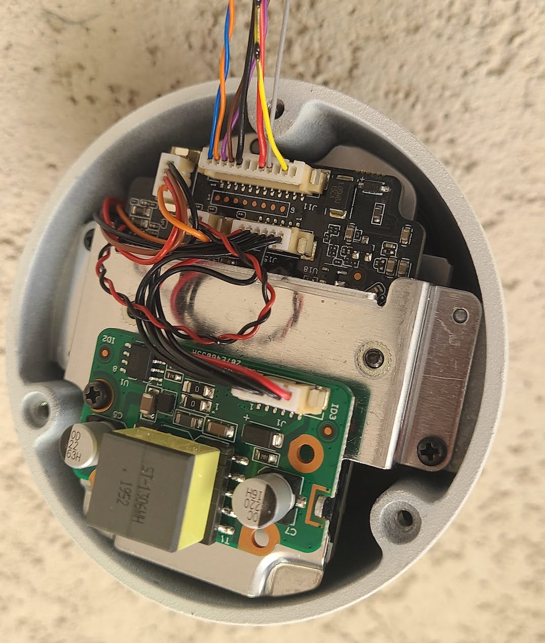

I upgraded to a new router that has different IP configurations. I'm looking for a reset switch on my camera but am not finding one. Photo of the camera is attached. Not sure which model this is. Any help is appreciated!

going to guess it is under C7 on bottom of black PCB
top green pcb c7 under that area bottom of blk pcb

Well for that camera it looks like normally a Through Hole Cap would be where C7 is. That would be bottom side of that area black PCB facing the front. Also another one with same type caps yours has would be at the Bottom of the camera board where the wires come into the Black PCB however you would be able to see that button and on yours it isn't there so that leaves C7 on Green PCB side of the camera under the Black PCB could use a 90degree pick or something that could push the button might be able to see it it isn't facing back it is facing side on the front of Black PCB..

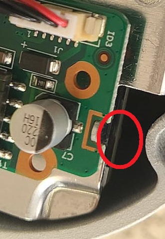

Re: Need help resetting without reset button
This area on side facing front of camera might be able to see it as I can't really tell in your picture but that is where I think it is

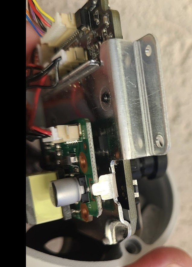

Awesome, thanks for your help. I couldn't see it until I took the PCBs out - but can now see the reset button hidden on the side. Very hard to see in the assembly, but just to the right of the C7 as you suspected.
