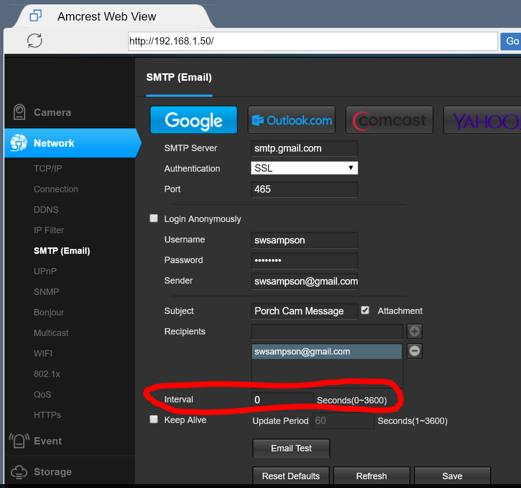

Under set up > Network > SMTP (Email) , set the interval to '1' oe '0'. This should send three images per email.

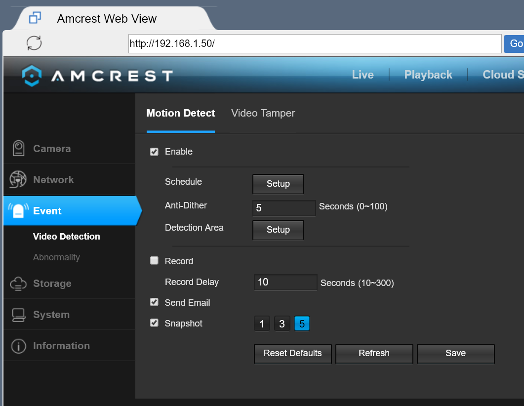

I have this same problem and tried the setting Melvin suggested but it's still only sending one motion detection snapshot with the email. Anything I'm doing wrong here? I have an IP4M-1026.
