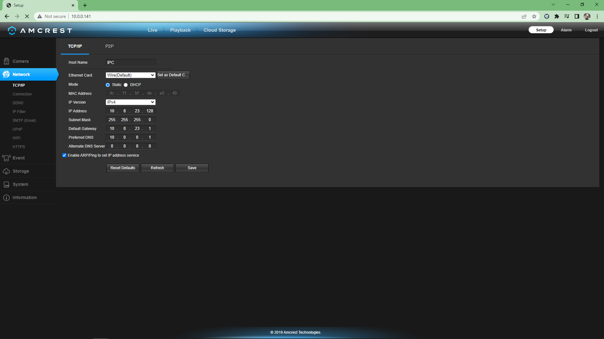

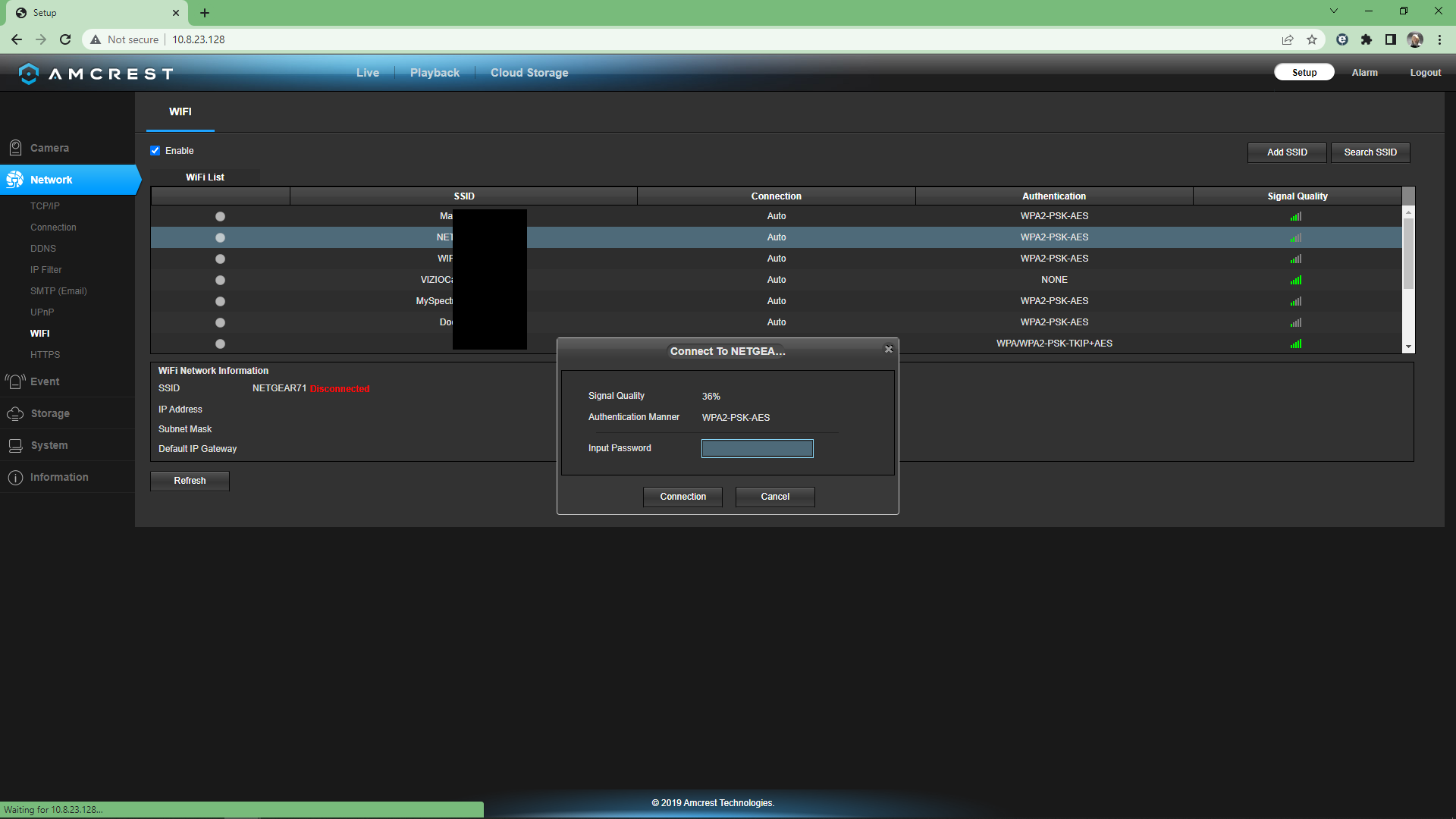

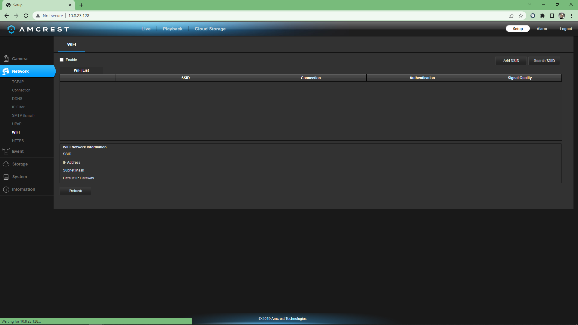

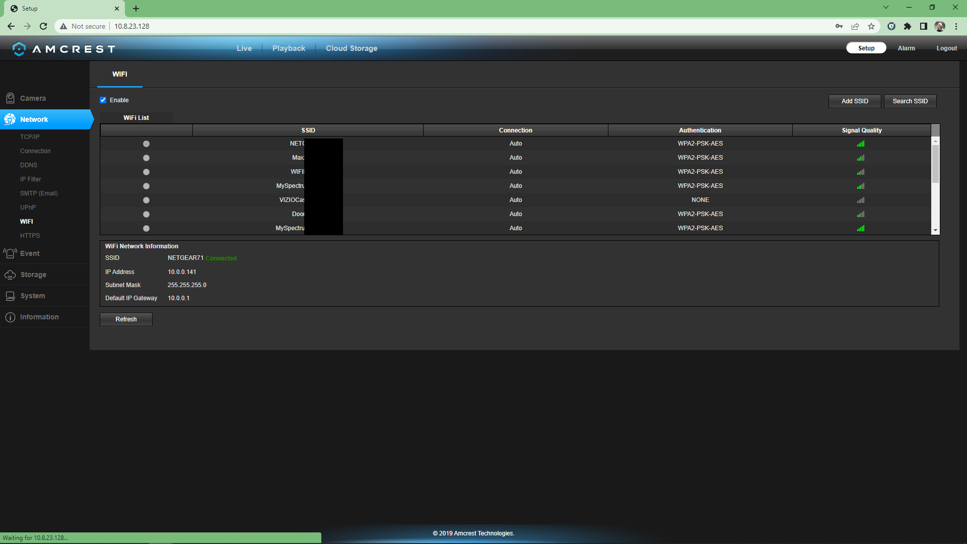

So if you look at my Pictures.. My normal connection for my network is 10.0.0.xxx I have setup camera to use 10.8.23.128 and my computer will be 10.8.23.119 and you can see in the pictures that I make a connection on my camera at a wifi ip address of 10.0.0.141. I then turn off wifi from the setup network area. I then connect back at the 10.8.23.128 ip address via cable from my computer to my camera then in the last 2 pictures you can see where I am asked to put in password for ssid I want to connect camera back to. then it shows that it is connected in the last picture..
Connected on Wifi showing what my IP for my camera cable connection is going to be

Picture showing that the camera is on wireless connection as ip states

Showing connected on 10.x.x.x address with no wireless connection

Picture showing when I pick the wifi I want being asked for password for wifi ssid

Picture showing that it has connected to the SSID I wanted
