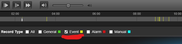

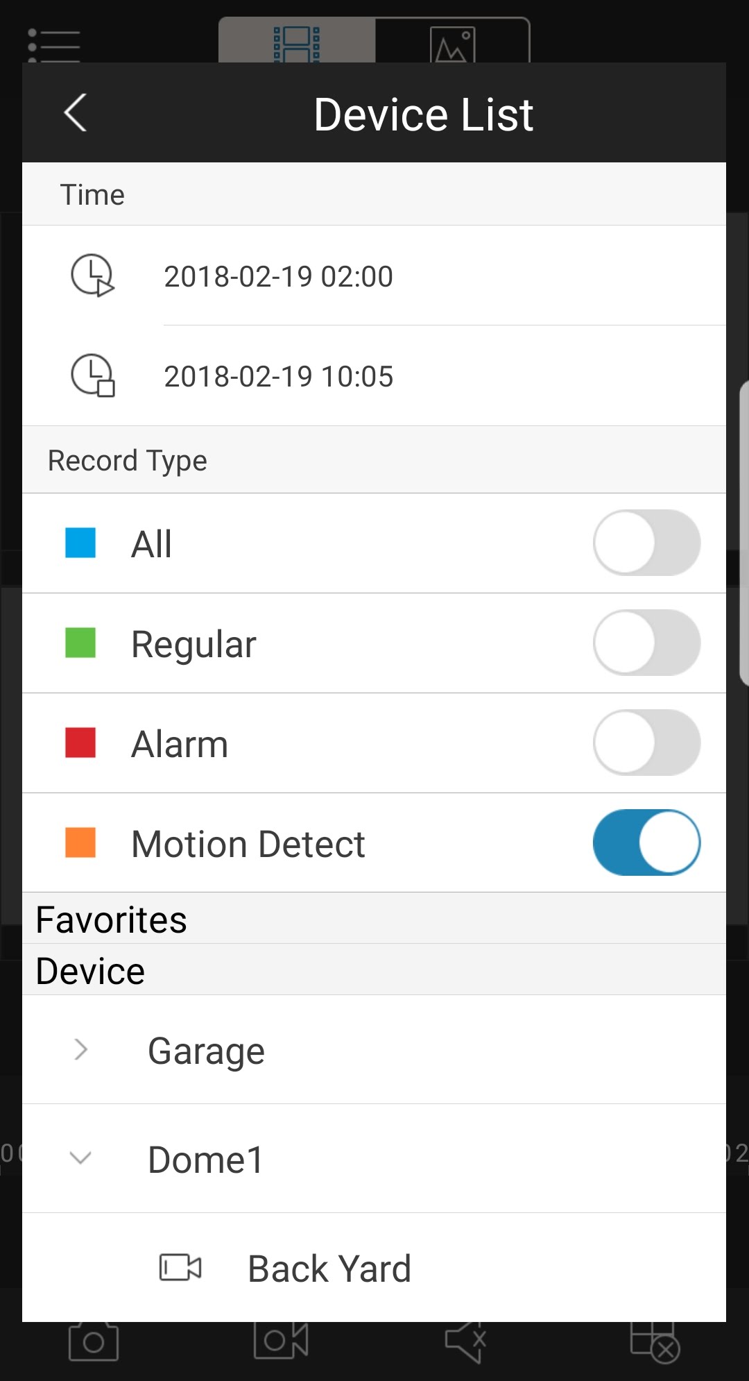

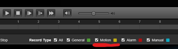

I cannot playback recorded motion clips from the IP4M-1056EW within the Amcrest View Pro app on Android. I also own the IPM-721B and can playback motion clips from that camera just fine within the app.

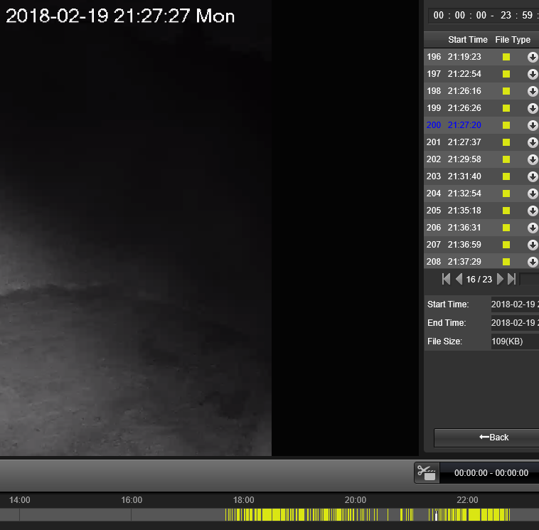

Both cameras play back recorded motion clips just fine when I view the interface via Internet Explorer - but I have noticed a difference. The functioning camera (IPM-721B) marks the motion clips as "motion" while the other one (IP4M-1056EW) marks them as "event". My best guess is that the app doesn't count "event" as motion so it will not load when I try to play it back. I simply get the "no recording found" message every time when setting my search parameters. I can watch continuous recordings without a problem, but not events.

IPM-721B (Works via app)
IPM-721B with motion
IP4M-1056EW (doesn't playback motion within app)
IP4M-1056EW with event instead of motion

I also tested the iOS app and noticed that it doesn't even let you select motion events for playback. That's a pretty big drawback in my opinion. Maybe I am using it wrong?

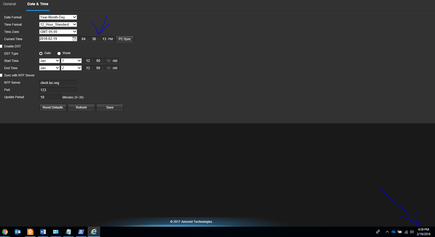

The date and time is correct. The camera has the right date/time overlayed when playing back footage too.

Thanks for the response. The date and time is correct on the camera and when I play back events via Internet Explorer they line up with the corresponding time that is chosen (the timestamp on the video matches the actual time they were recorded). I really think it is an issue with the fact that the camera is labeling motion as "event" and the android app doesn't have an option to view "event"

I had a similar issue and found the solution was resetting the default date/time format. This includes changing back to 24hr time format, as I see you have 12hr set. You may try giving that a shot. Hope this helps!

Thanks for your input! I changed the time format and rebooted the camera but no luck. Does your camera show "event" or "motion" as a playback option when viewing in a web browser (see my photos above)? I know I seem hung up on the event/motion thing, but that is the only difference I have seen so far.

Just checked and all my cameras have "Event". I believe the time/date is incorporated into the file names, so anything that was already recorded with the 12hr format is already set. Did you try recording some new motion events after making the change to 24 hr format?

I do have new events but they aren't playing back in the android app (only IE). I did try removing and re-adding the camera from the app.
