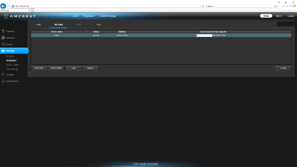

So when things get kind of Icky for lack of something better to call it I Found that the little MSD that was installed in the camera was full...
Found this to be true on my 751 and my other cameras in fact I just found that after a Format the 751 that is working at Wifi has stayed connected now hummm Dang I keep forgetting that when I have connection issues over Wifi it was related to MSD too grrr...

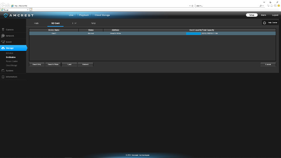

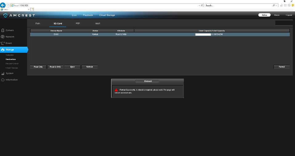

Anyway go to the WebUI, then Setup, then storage, Destination, SD Card. Then you will want to click on the MSD it will highlight the line.. Then click the format... Then depending on what your doing this on it will reboot maybe or maybe not... However once done your card will be back to lower number used and ready to go...
So I did a Different camera to show what it would look like to format and after it reloads with a good format because the first one I did I have to save some files first...
