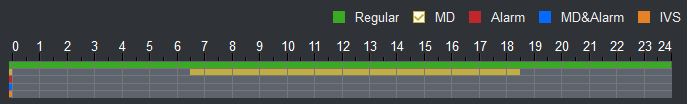

Yes so in the picture that you have there, That will give you full time recording and motion detection at day time. So for what I was saying if saving space was something that was important then in your times you want motion remove the Full time Recording and the times you want full time but not motion then remove the motion like in your picture it will have motion events from 630ish until 630ish pm to be honest full time would be best for most camera locations to make sure something isn't missed outside the cameras motion detection area. Also good to have full time on if your cameras have Mics because things could be caught on Audio that might have been missed if only Motion record is on..

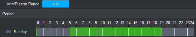

I understand that Storage - Schedule - Record Schedule configures the NVR to record Regular (full) and MD to the hard drive based upon the selected times.
Does Regular mean the HD is recording everything the stream from the camera of everything the camera is seeing?
Does MD mean the HD is only recording during a MD event?
If yes, then when playing back MD events, how much time of the event will be played back? Does MD playback 10-20 seconds before event, the event and some amount of time after the event?
What is the purpose of Event - Video Detect - Arm/Disarm Period and how does this setting effect MD? Does the setting control when MD events are monitored?
If yes, then based upon the above picture, will MD events be ignored between 0-4:59 and 19:00-23:59?
Does that mean that e-mails and notifications will not be sent while ignored?
Thank you,
