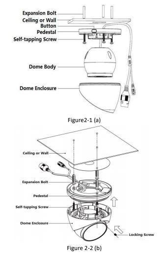

I have the T2499EW and it can be manually oriented any which way within the dome enclosure.
Link to the manual: https://drive.google.com/file/d/1ciMk7h ... DrarF/view
