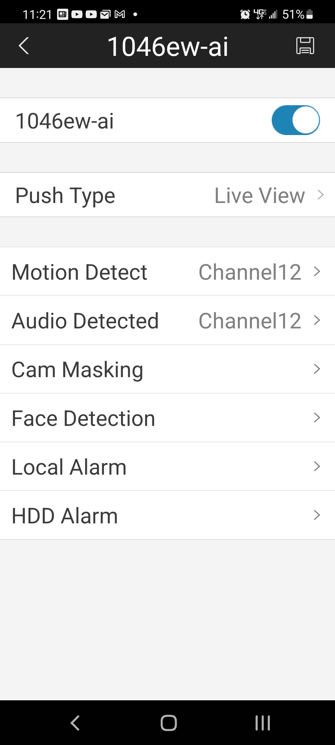

The app isn't updated to a new enough date to have IVS and SMD installed. However there is some data for Face Detection if you use the Push Notice part of the App you can choose Face Detection as one of the options if you had a camera that was setup with that option.

here is a picture of the Face Detection area in the Notices for AVP
