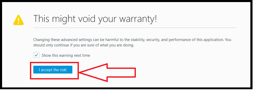

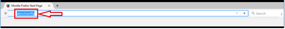

As of the latest update of Mozilla Firefox, they will be discontinuing the use of plugins and causing not being able to access the your device using Mozilla Firefox. The plugin will affect the ability to view and playback options. Setting changes will still be available using this method on most devices(HDCVI systems will not work).
We are currently working on a more permanent solution to the issue. You can try the below work around if you have installed the latest version of Firefox.Please note that Firefox does not recommend this to be a safe method.
Step 1: Input about:config in Firefox address bar, hit enter
Please select “I accept the risk”

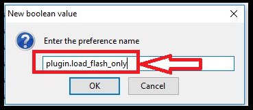

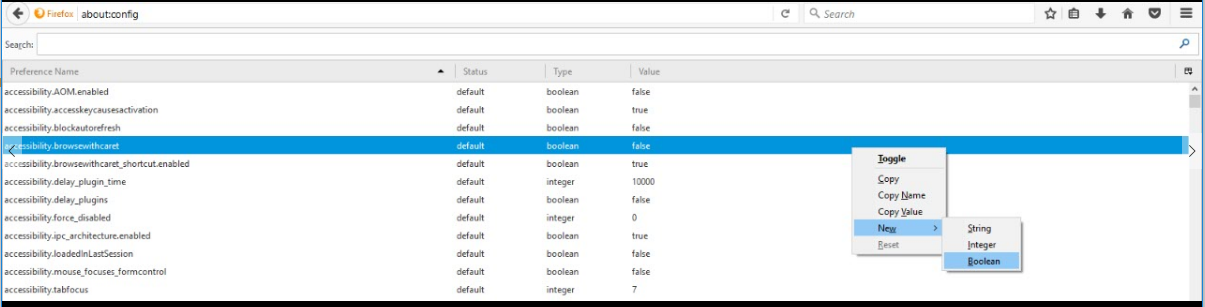

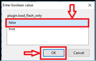

Step 2: Right click and choose New, then Boolean
Please input name: plugin.load_flash_only
Then click OK, choose false and click OK again.
Then please close and restart Firefox and try again.
