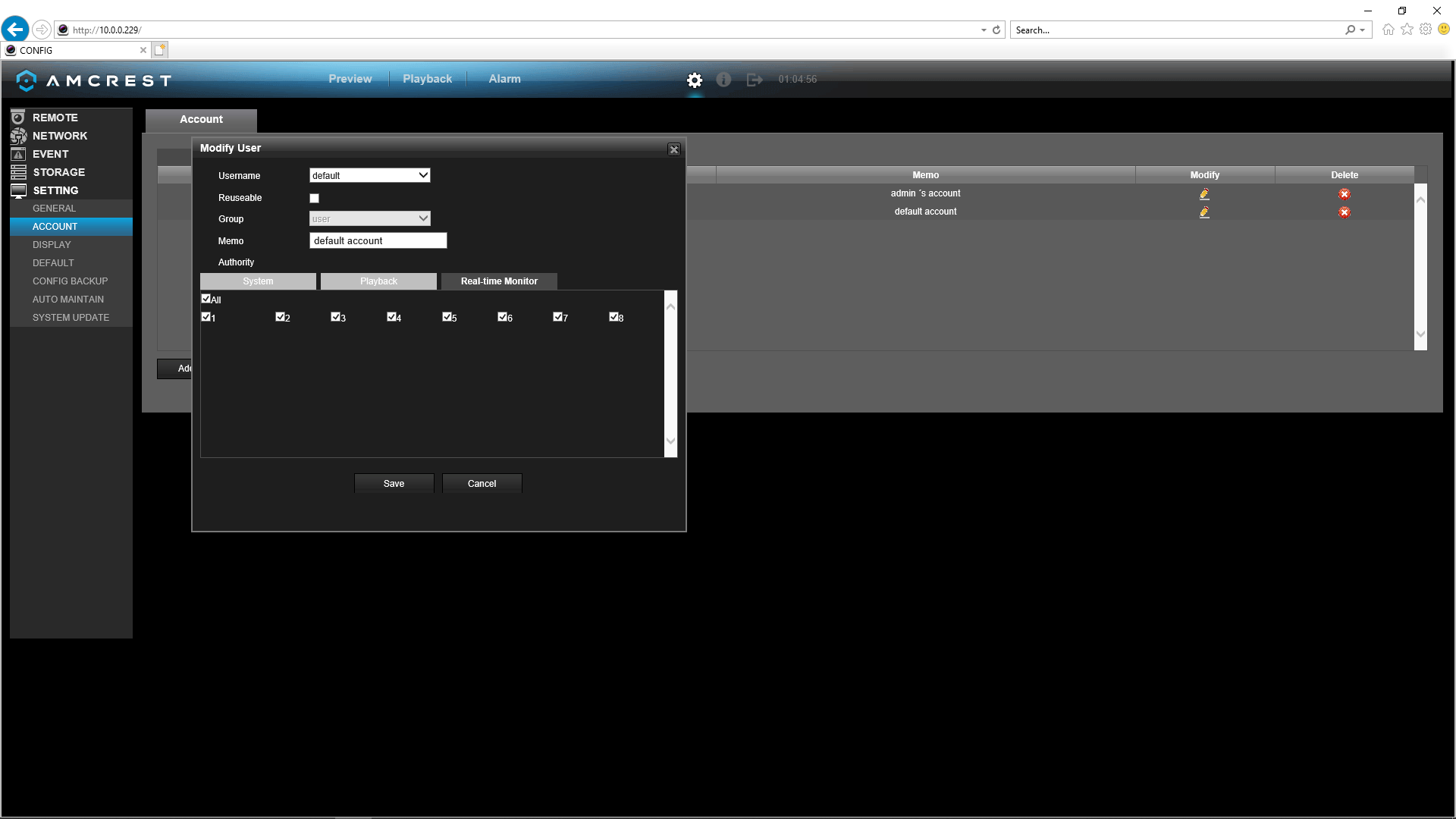

So what you do is click on the add new and make a new user then pick the user profile.

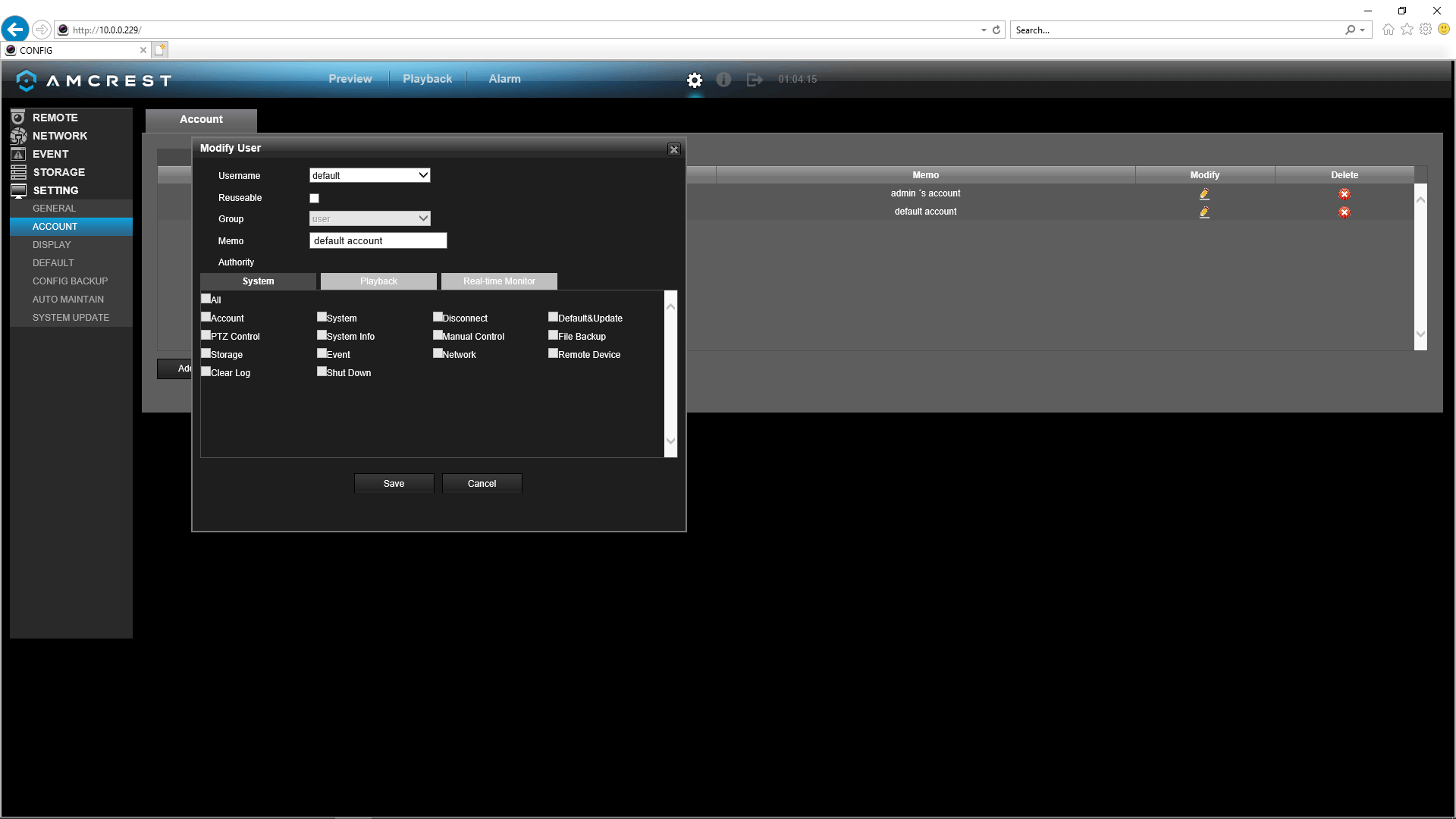

You will want to go to the Profile and make changes to what you want the user account and the ability behind it... SO maybe you don't want them PTZ your cameras because some don't have the ability to return to a home spot so it might not be smart to let them have that access so you un check it... So this is some screen shots of my NVR user right now I have them all un checked and have all the live view checked as what user can do right now NOT MUCH lol...
So on the Live view and Play back maybe you don't want them to have access to your Backyard because it has your POOL So you can take out say camera 7 and 8 or if you had a 16ch you can take out 14 15 and 16 from the ability of them watching them cameras. Also maybe you don't want the users to have any Playback so you can take that all away... just CLick all and they are un checked...

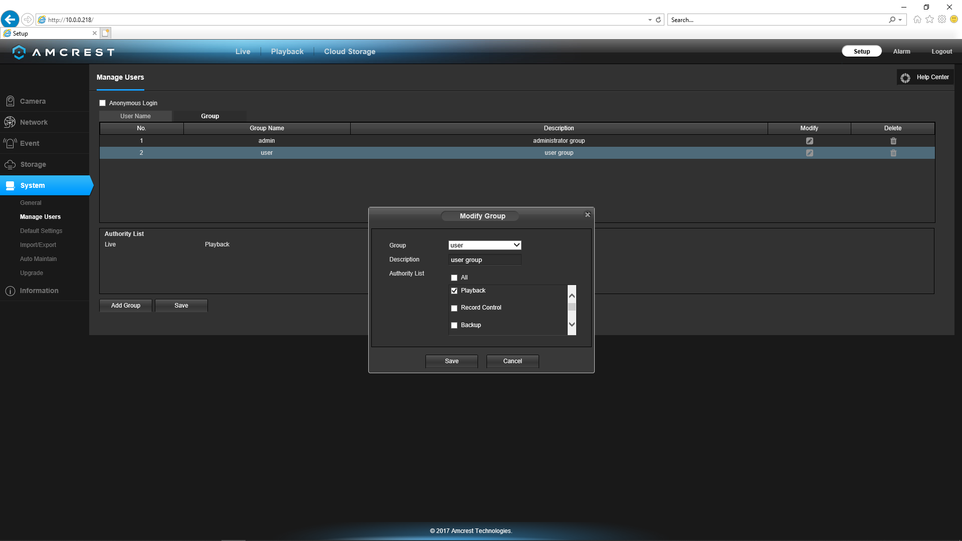

So for the Camera you can setup the Group user as a general role. however lets say you want to have your Son have more control over the camera. You could give them Admin role and even with that you can take away rights you don't want them to have. So you remove the rights and save. However your brother you want them to have access to more of the camera control but only under User, Right now your General User is only for Live View and Play back but you want them to have access to your PTZ and logs so you check them and he will have access to that over the normal user. The next user you add again only has the Live View and Play Back until you give them more if you wanted or you maybe only want them to have Live view so you uncheck Playback an save...
Just remember the roles as they are now is how they setup by default everytime you set them up... So you can give or take now in 1 setup as a user because as you are setting up 10 user accounts it is easier to just make the role and when you setup the 10 they have that default maybe 11 and 12 will have extra abilities.. You can always go back and make adjustments maybe you have a Manager but don't want them to have all Admin rights as they grown into them you can add them without having to make a new account...

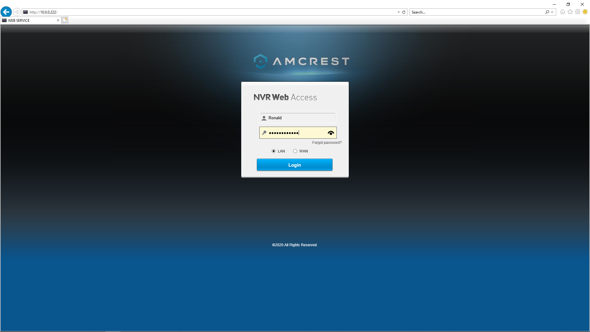

Looking at your WebUI log in it looks like your trying to log into your Routers DMZ on a forwarded port? however if your camera is on the same range as your computer and you didn't change access to port numbers and let say the camera is on 192.168.1.149 IP.. Then the User would type in that IP address then when the log in box comes up they would put in their user name and password... However in the event you changed the port then it would be the 192.168.1.149:8000 like in your post then again when box comes up to log in they would put in the acount you made for them and the password
So this is what it would look like to have my Son Ronald Log in to my NVR

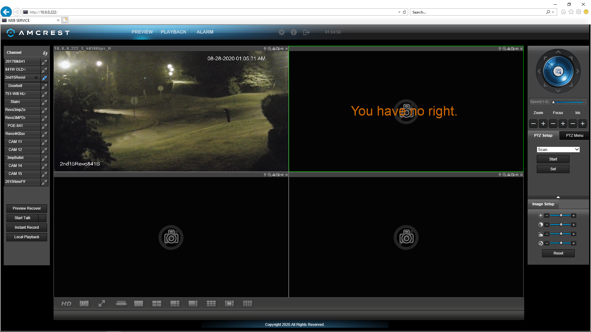

So I also thought I would show what it would look like with Ronald signed in and if he tried to access a camera that isn't on his list of viewing there are more then just the one but only added 1 and then added one he don't have access too to show
