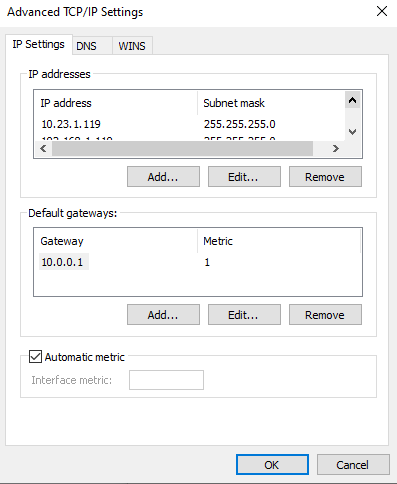

Anyway I have my computers setup with a Static IP and then I add extra IPs to a pool of IP's that my computers are able to connect to. Anyway it is under the networking tcp/ip v4, properties, then advanced area where you add more IPs. Don't really show much but in the picture below you can see one of the IP's I have setup and the top of the other in the picture.
Screenshot (3902).png (12.03 KiB) Viewed 3316 times
