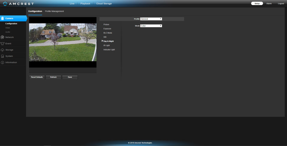

I have an IP2M-841 where the image has gone from Color to B&W ? Its the only one of 5 which is doing this. Is there a setting somewhere that changes the camera to B&W or am I looking at a Camera that has lost its color Image and will need to be replaced ?
Thanks in advance, searched the forum and didn't find an answer, I am at the 8.3.2019 build in case that matters.

Hello Dan,
Sorry to hear your having some issues.. There is an area under your Setup that you can tell each camera to work in Color or B/W yes.. However be it known that it can get Tricky as there are really 3 types of setup...
If you have it setup for a Schedule then it would be on or off by a time or it might be that they have it set to B/W in both times set...
So log in to camera, go to Setup, Then Camera should be showing.. It could say General and in that case all settings are going to change for General however if you have it showing day then changes will be in day.. anyway in General of the Drop down on the right area then below to the slight left will be Day/Night then in General again of the drop down change it to Color
Re: Loss of Color
So forgot to add that if you wanted to have it in Color at all times change the settings in General, Day and Night all to color, If you want it day time in Color and night time in B/W then set it as so and under Profile Management change the times you want day to start and Night to start.. Then also under night you can have it setup for IR on IR Smart or IR off... If you will use it though a glass then you will want IR off
