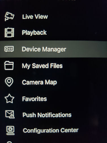

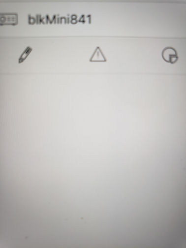

in the App go to the Device settings, click on the Pen icon for editing. Then click steams and change and try to have them set on extra if set to extra for kicks try them on Main then click the LiveView button below.

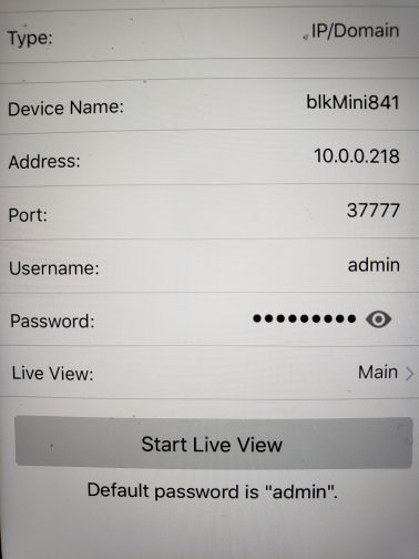

Well in my images one thing that is wrong to work with an outside view is I have mine set to Ip/Domain and while it works in the Network once you leave the network then you get them messages...
In that case you would want to delete that camera out of the App and set it back up. This time when the Page comes up Click on the top right where it says Camera already connected device, then next page will come up with P2P or IP click on the P2P, Then next page will ask you for the SN of your camera, You can scan the QR code off the camera or click below to input manually. Next, Put in name, username, password, and now click on View livefeed... Once you can do that.. Then turn off the App. Turn off the Wifi on your phone. On Cell phone data load the app. it should play the last camera you had listed... Now should be running on your phone over the Cell network...

Revo2Maxx wrote: ↑Mon Jan 27, 2020 11:51 am Well in my images one thing that is wrong to work with an outside view is I have mine set to Ip/Domain and while it works in the Network once you leave the network then you get them messages...
Now it worked, thanks for help.
