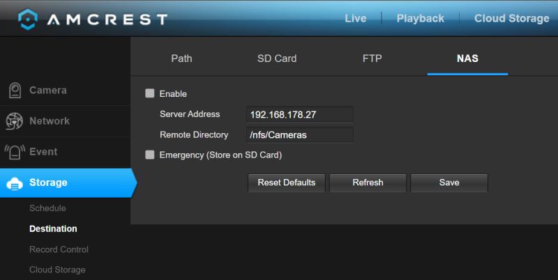

Well my experience is limited to the two types of camera in my sig. The webui/setup/storage/destination tab looked like this, enabled of course. N.B. you must set and save the storage path first before entering the NAS details -
One thing that caught me out was that I had to add the " /nfs/ " to the remote directory field to make it work, but that of course is talking about my WD.
I don't know of any implementation of SMB for this purpose. Sorry I can't be of more help
p.s. - The test button does not appear until you have set "NAS" in the path tab and saved it and then entered the access details in the NAS tab. In my screenshot it doesn't appear because the option isn't enabled.

Excellent, this was a tremendous help. I'll change the syntax of the "Remote Directory" field to include a leading '/' and test it again on the NFS share on the Buffalo NAS. If it still doesn't work, I'll create a newer NFS4 share and test that. If it works, I can still create an NFS share on a Windows machine and test further. If it doesn't work, I just might have to revert to a local FTP solution.
