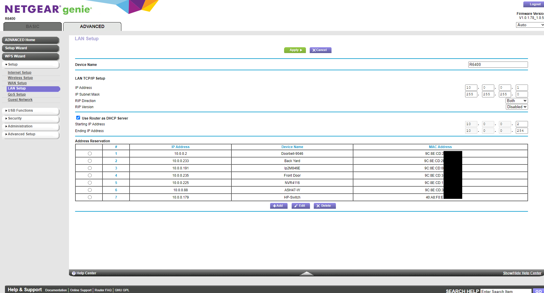

So there are a few cameras that do have the ability to make changes in the Smart Home app where you can change the IP address to static. However if your ASH42 is not able to do that then the best thing to do is log into your router, using the Static area within your router set the Static IP to your needs for your cameras. It will after that change start to keep the IP the same for your camera every time it restarts. It will keep track of this info from the Mac Address of your camera..
My ASH47 needed to be set static and some of the others like my 4116 didn't in theory because I always setup for Static when setting up. However did setup for Static so it would always use that even after a Reset to factory because I was doing this often for testing some things..
In my list of devices 4 of them are Smart Home Products that I wanted to keep with Static IP and while my AD410 says it can set static it didn't' work well in app so I set it in Router.

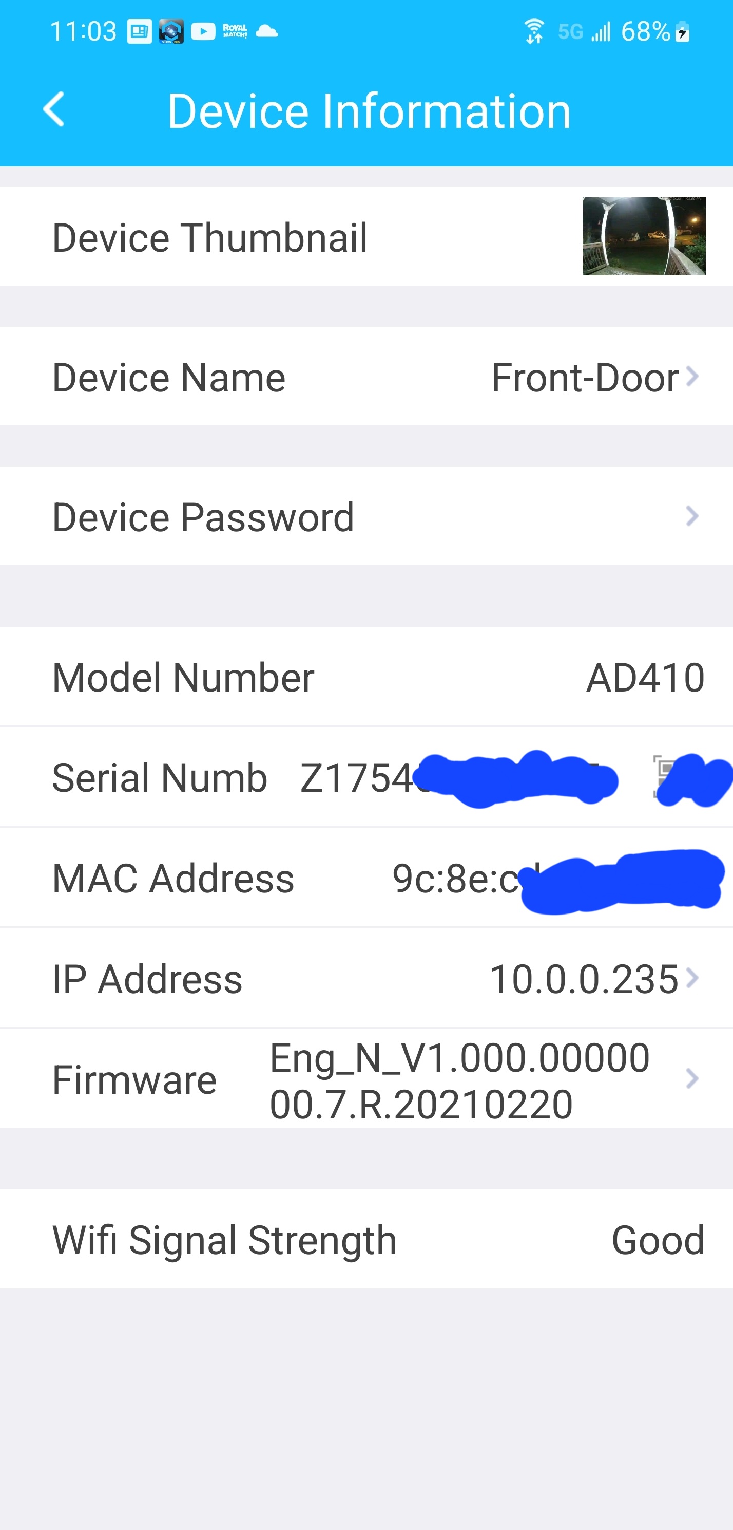

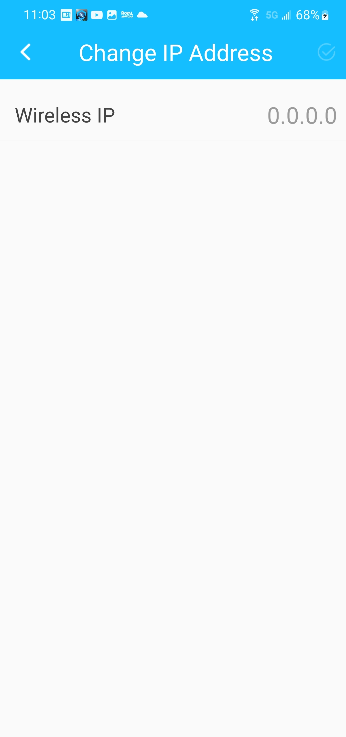

Sorry forgot to tell you if you have not seen it, Bring up the app, click on the camera you want to manage, then click on Device Information at the top. Then it should bring you to where it says what the MAC is and under that it will show the current IP if it lets you change it you can tap on the IP and it will open another window with 0.0.0.0 installed. Change them to the IP you want and when you save it should save.
However if you try to Tap on the IP address and nothing happens then there is no setting for you to change your IP and you will need to do so VIA your router..
