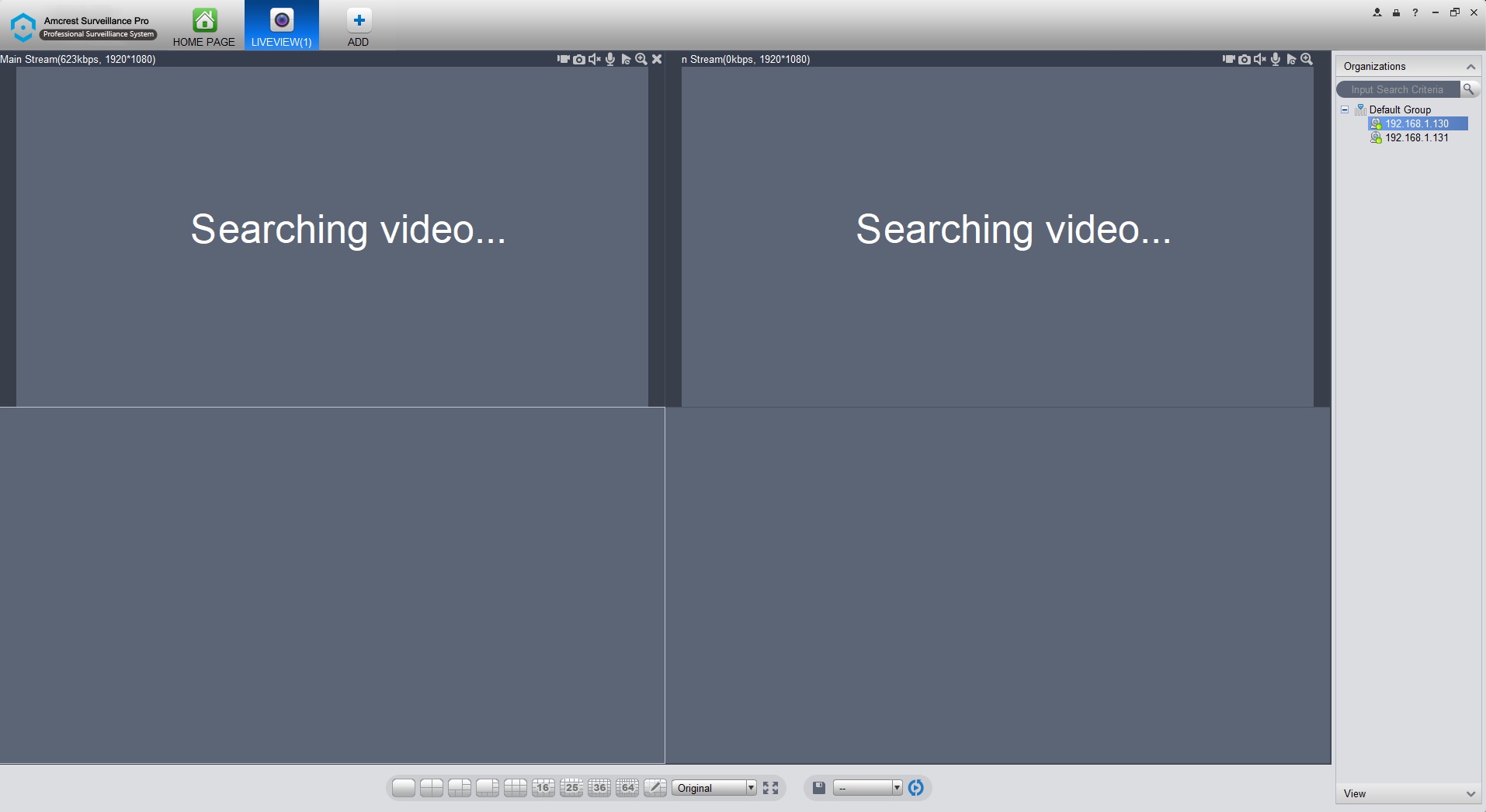

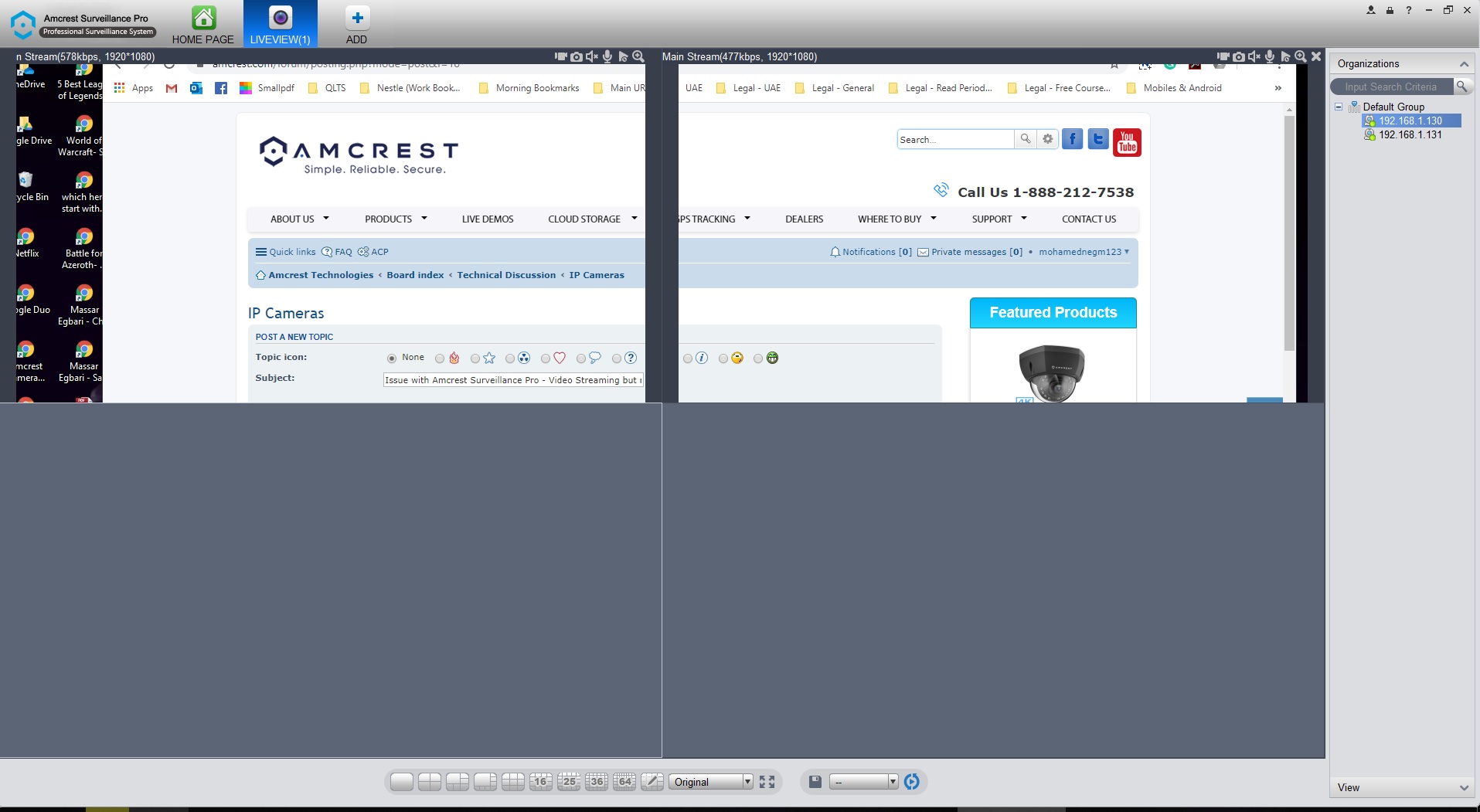

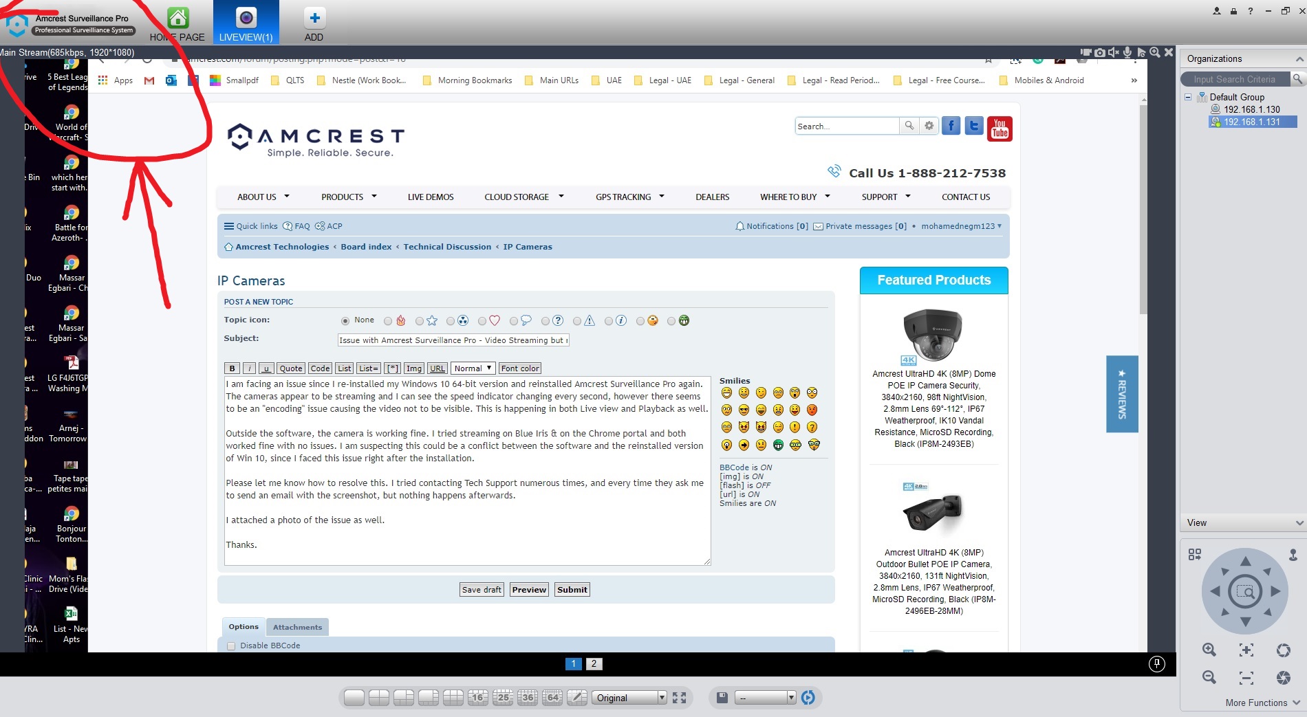

I am facing an issue since I re-installed my Windows 10 64-bit version and reinstalled Amcrest Surveillance Pro again. The cameras appear to be streaming and I can see the speed indicator changing every second, however there seems to be an "encoding" issue causing the video not to be visible, and it just shows the last thing that was open in the background (check the attachments). This is happening in both Live view and Playback as well.
Outside the software, the camera is working fine. I tried streaming on Blue Iris & on the Chrome portal and both worked fine with no issues. I am suspecting this could be a conflict between the software and the reinstalled version of Win 10, since I faced this issue right after the installation.
Please let me know how to resolve this. I tried contacting Tech Support numerous times, and every time they ask me to send an email with the screenshot, but nothing happens afterwards.
I attached photos of the issue.
Thanks.

Was this ever resolved? I have tried 4 computers and the only one that works is my work PC? none of my personal computers manages to show a live stream? only searching video. This tell me in it is on the PC side and not the NVR or the Network side.. I do see live bandwidth and can take a snapshot of the feed. just no video on screen. I tried installing DIVX as maybe its a codec issue but nothing. I have run out of Ideas... HELP!!

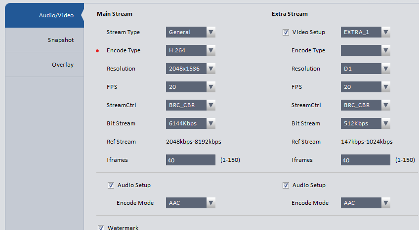

via the Amcrest Surveillance Pro Software
Goto Device CFG then under General click Encode and changed it to H.264

I'm having the exact same problem the original poster did. I am running the Amcrest Pro in wine on Linux Mint 22 and everything works except the camera's aren't visible. Says "Searching Video" and no picture. It is running in the background, I can see the numbers in kb of it downloading and I can take a snapshot and that works.
I have this installed on a windows laptop and it works fine. I also have the Amcrest app on my Android phone and it too works fine.
I've searched the internet over and over. The only result worth anything comes back to this thread but no solution was ever posted.
HELP!
PS. I did check and mine is already set to H.264 as mentioned in the previous post. I also tried H.264H with no luck.
