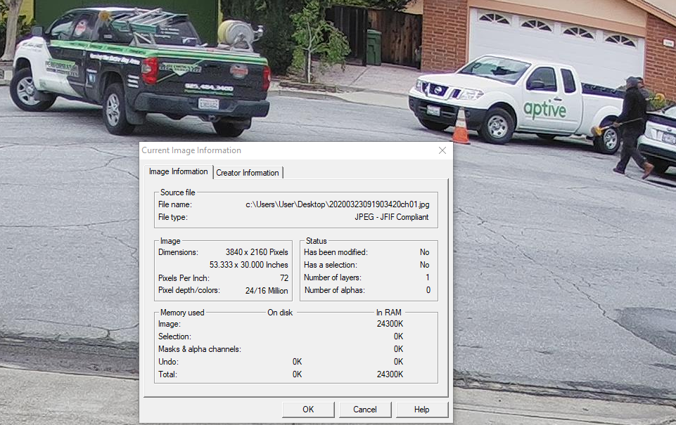

Dan, just got mine a week ago and it snaps with motion detection, and emails at full 3840x2160 with no issues.
I'll keep an eye on them if they start failing but so far so good.
Only issue I have is trying to view 4K video from the built-in web gui freezes, showing only the first frame. It does this in the live view AND the player.
