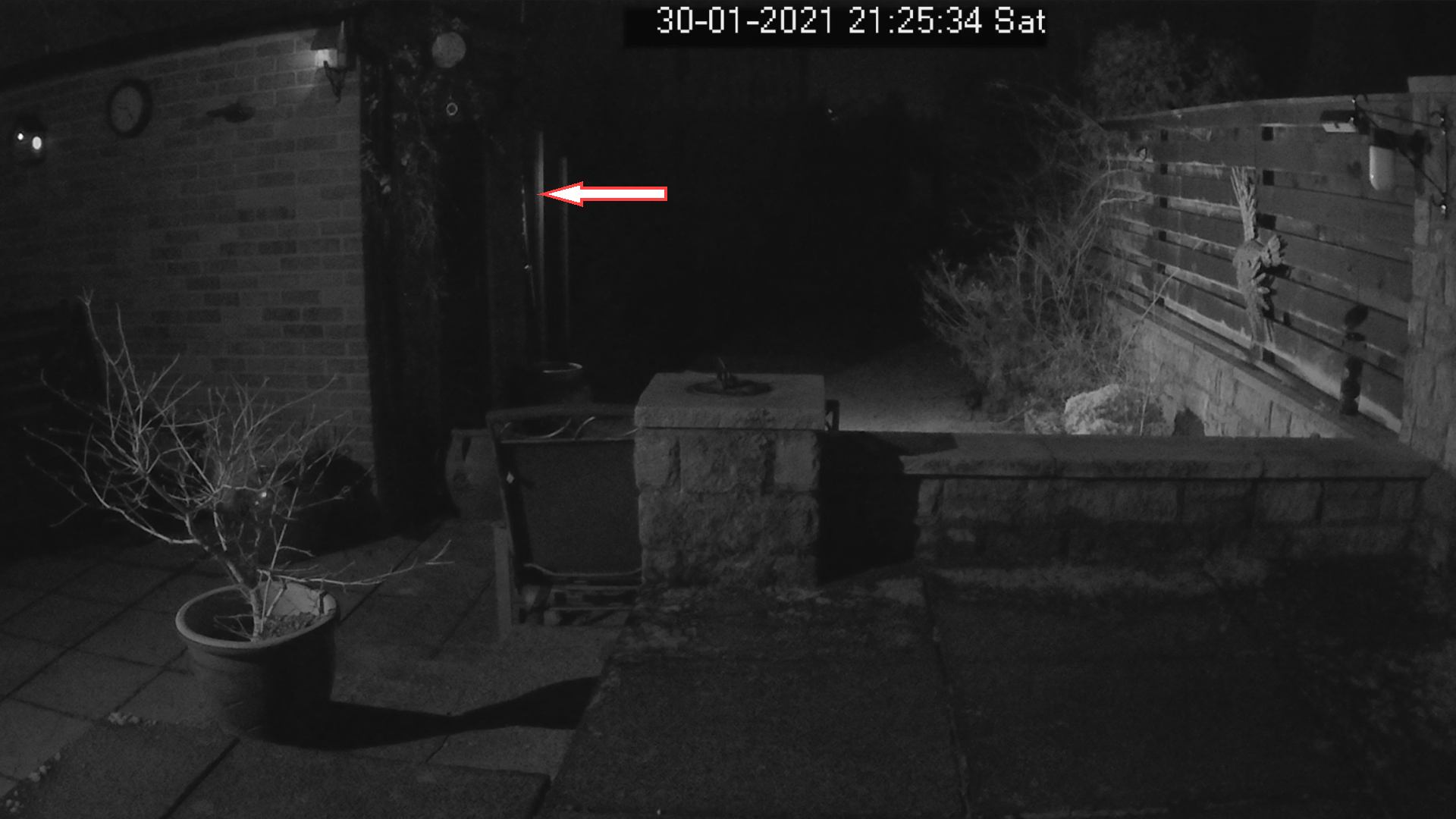

Revo2Maxx is correct. I have a couple of IR illuminators ( https://www.amazon.co.uk/T-L2019C-Tonto ... 444&sr=8-3 ) and they work well for me.
One of them is on a shelf inside my greenhouse, the arrow marks where the light is and this is the current view from my indoor camera. The pool of light on the fence is from the greenhouse light. To the naked eye, my garden is in complete darkness. The foreground is illuminated by IR from an external camera which is attached to my NVR.

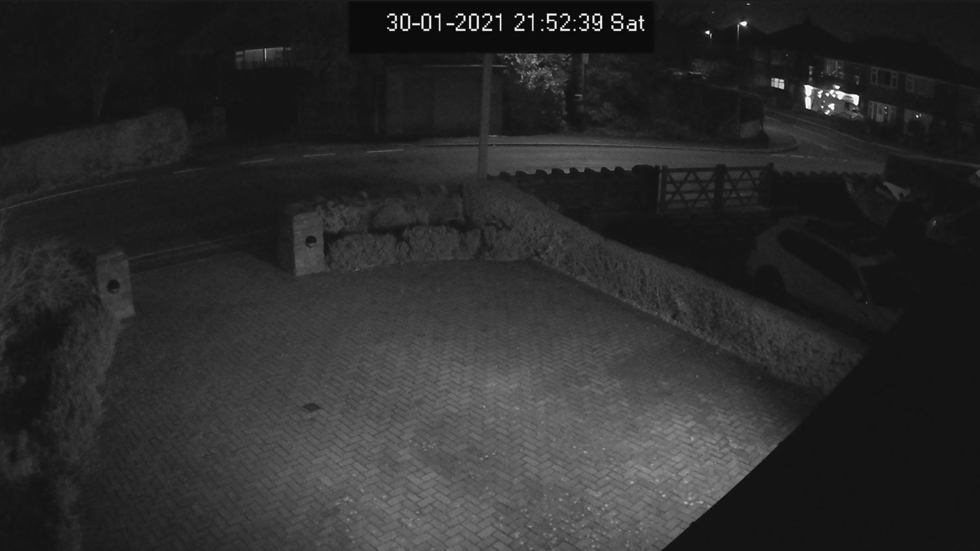

My other illuminator is mounted externally and also complements the light from an external camera on my NVR. Once again, to the naked eye the whole drive is in complete darkness.
