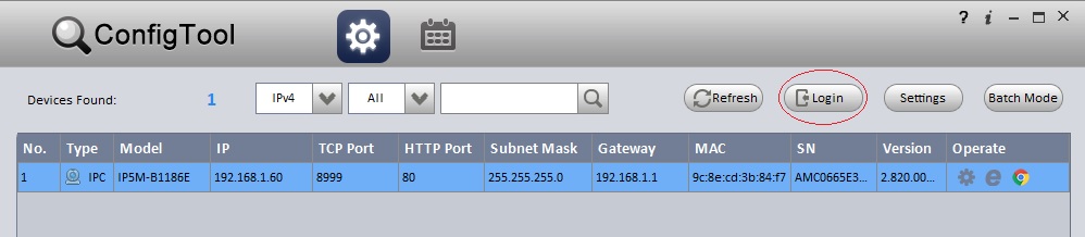

Is this where you are entering the user/pass credentials for the camera? If so, it should log you in given the correct username and password for the camera. If not, you may need to revisit the initial camera setup or start from scratch again from a factory reset.
IPCT Camera Login.jpg (54.32 KiB) Viewed 8421 times
