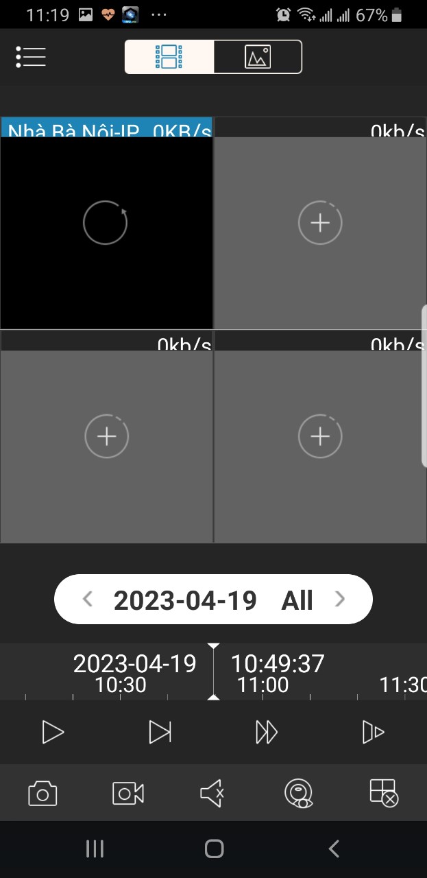

My IPM-721s 's got 16G SD card.

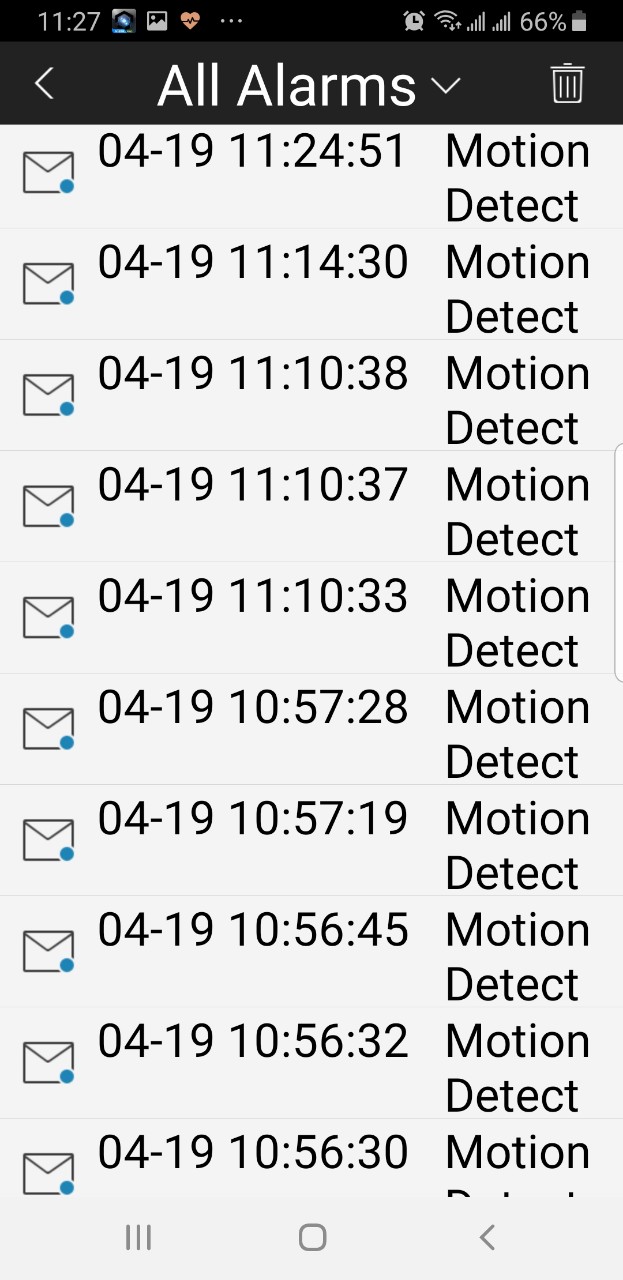

i's configuration "active" ---> Event List watched ok (when camera 's motion detect). BUT MENU "PLAYBACK", I choosed this camera and day (ex" 2023-04-15 All) ---> i watched only one detect (~10s) while Event List 's got 20 motion detect.

i used Amcrest View Pro on Samsung.
i login menu Push Notification ----> Event List 's got more Motion Detect ----> click any motion watched ok, but i login menu Playback not record or only 1 record ~10s.

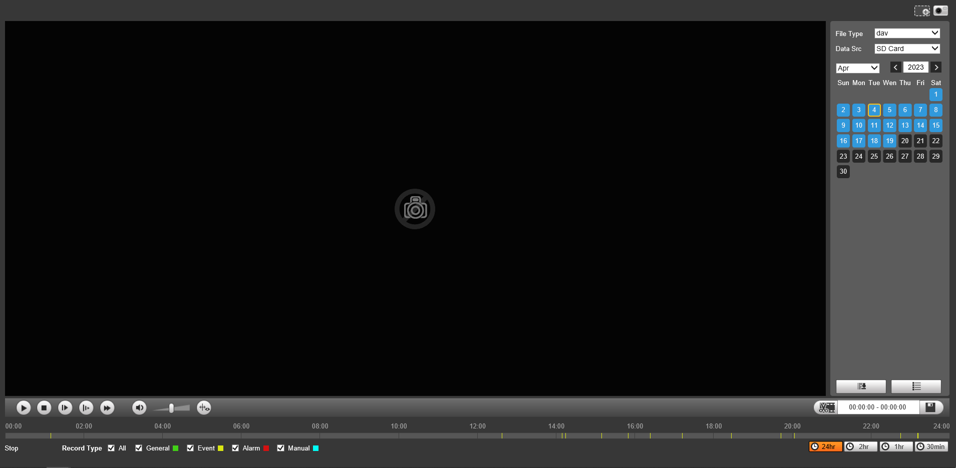

To tell you the truth, It would be best for access of your cameras using IE or IE mode in Edge seeing the camera is older FW type before Chrome. With that you have better control and access to the camera and playback. For me anyway the phone is for access while I am away..
If I am away from Home and want to have more access to my systems I use ASP with my Devices setup in P2P mode on ASP I can access my devices and even access the WebUI of the device once connected. ASP can also playback both images and video

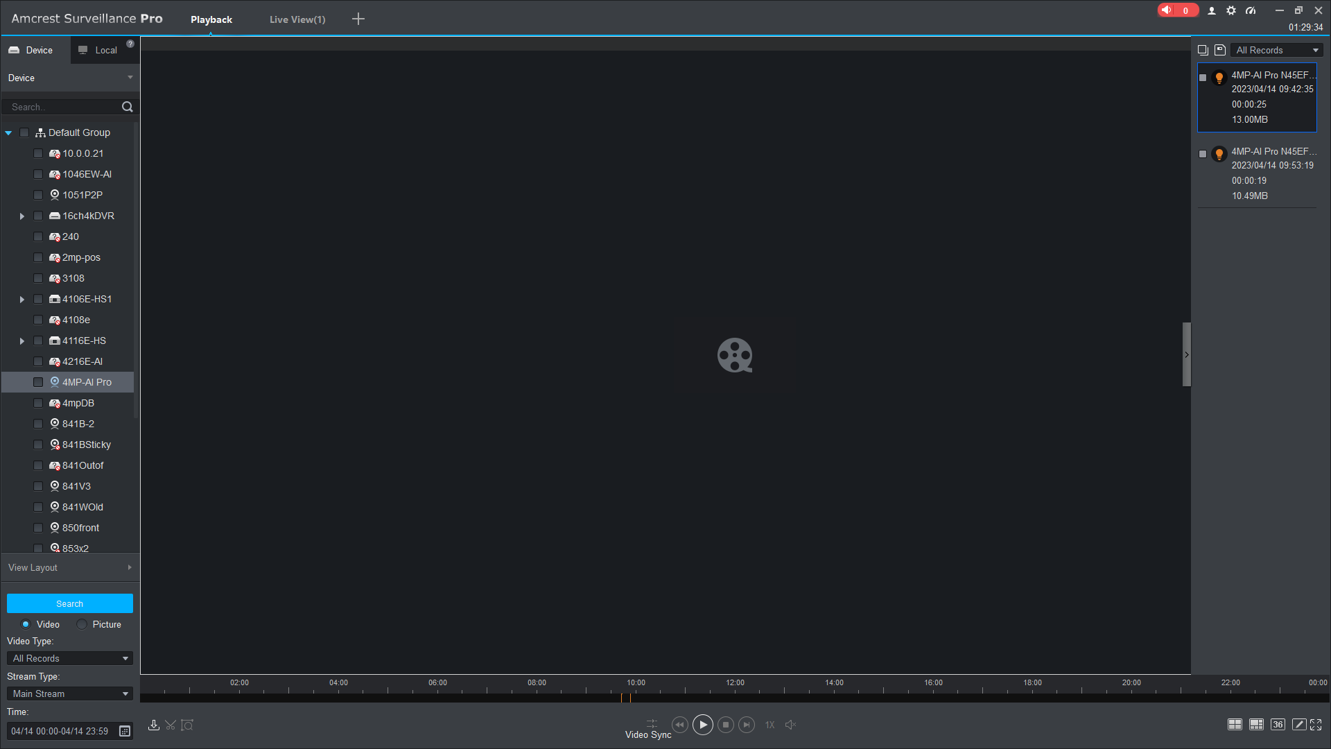

Here is some pics of WebUI for one of my cameras and another one showing access from ASP now it only shows the layout I just picked a random day for displaying playback and the AI pro on that day only had 2 events to list however it is to give you an idea of what or how it could look for your cameras.
