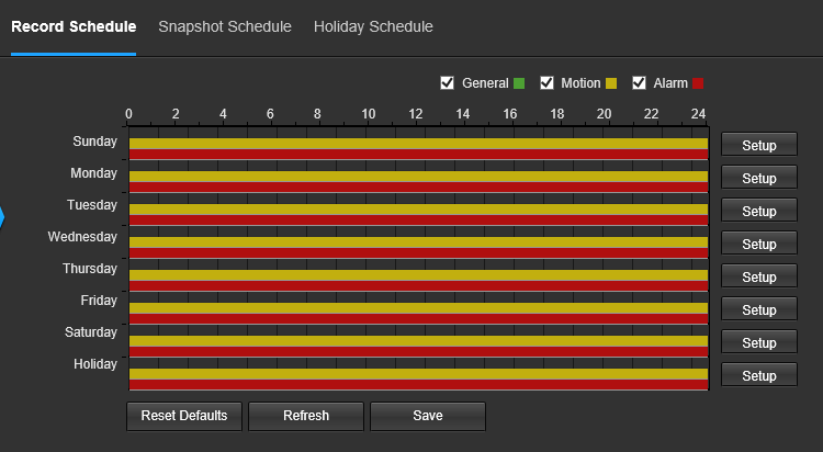

1) Under camera setup > Storage > Schedule > Set up, ensure general recording is turned off. The general record is shown in green color on the schedule graph.

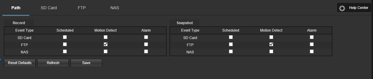

2) Under camera setup > Storage > Destination > path, ensure only motion box is checked.

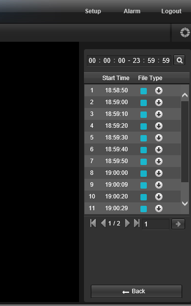

I have validated these settings and they appear correct. Motion detection is the only item selected in the path. Motion events are not enabled and the schedule does not have any general times selected. It continues to dump files to the FTP destination. I have defaulted the device and re-set the settings but the problem still occurs. I have attached some images.

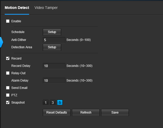

I see in the second image that the Motion detect check box is not enabled. Please check if that is the case.
Anyway it should not be recording all the time with regular recording turned off.
