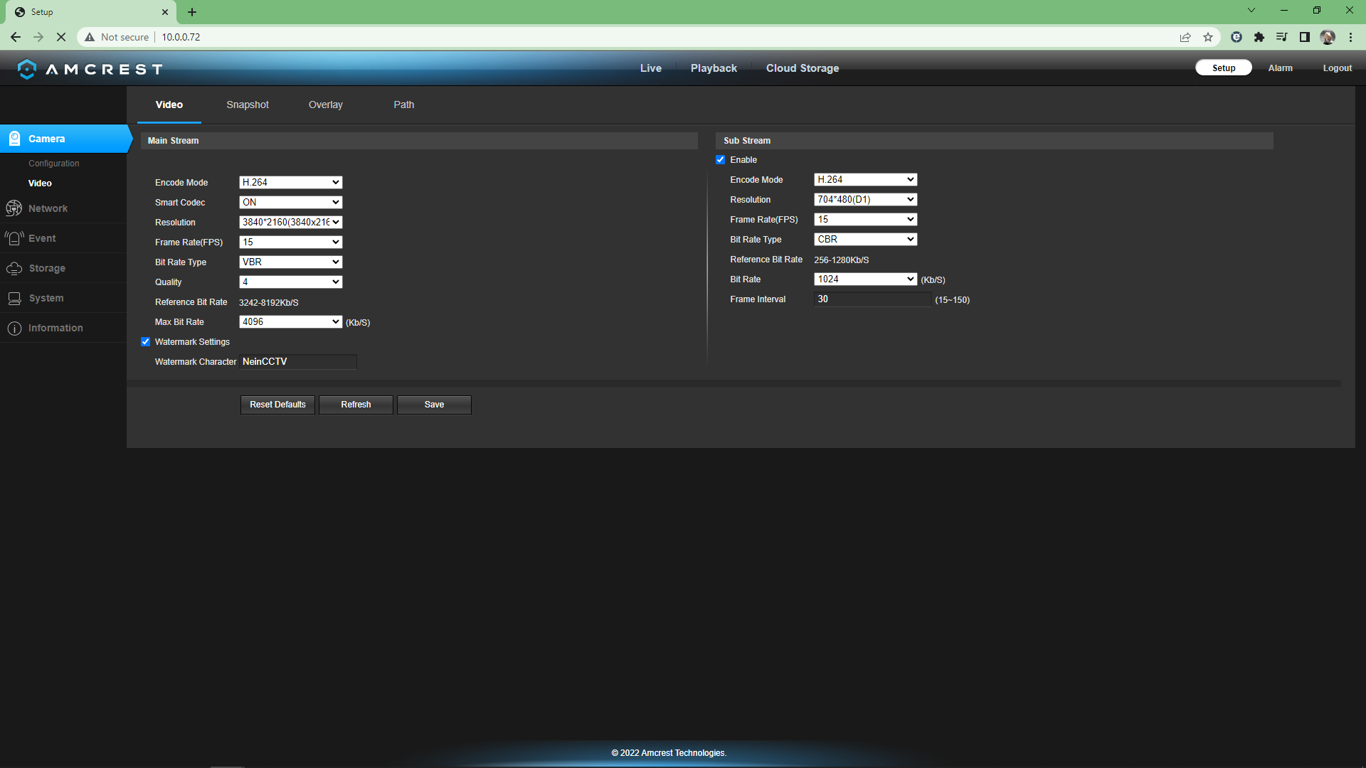

Re: IP8M-VD2893EW-AI - Issues with API being inconsistent
Also just so I was clear before..
If you look at these 2 settings and while I didn't change anything to save and only making the change from Codec type to on from off changed to the data that is in the second picture..
It might be that there was setting changed in the 1 camera that was not in the other and why one camera will take the SS command and other one won't just some ideas as I personally don't know why it would work for one and not the other...
