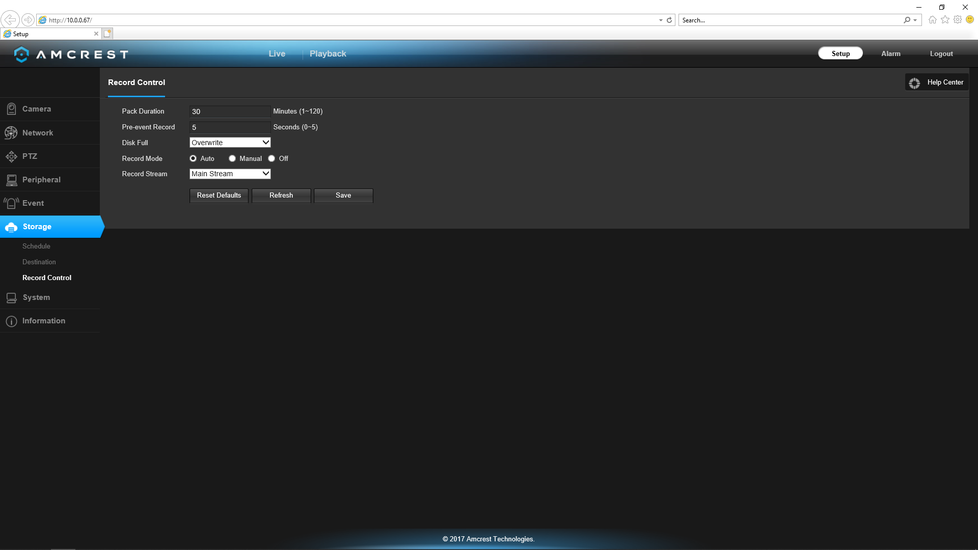

I would go with what Support has said.. Just keep in mind. If you were in the middle of Recording footage of an event and you wanted to shut the camera down just as the event finished then there might be an issue. So if there is something that I am worried about, I would always leave the camera keep recording past the package time that you have set..
So take for instance one of my smaller Amcrest PTZ cameras, I have setup for 30min packages. There is no telling where I am in the recording of that package and if someone just broke into my shed that it is watching I wouldn't remove that camera from service until after that time has ran. It very well could have been in the start of that time and power being removed might not have finished the packet. So for me after 30 past the event time it should have been recorded and even at that for me anyway I would have more then likely went to play it back and made a copy for backup..
Most of the cameras come setup stock with a 5 or 8 minute packet.. So I would look at how long your packet time is and just remember to go past that time before pulling the plug.. Personally my guess is that your recording to your NAS should not have an issue as it should be able to finish to the last captured frame. Sometimes that might result in freeze frame at the end.. Also I would guess that your NAS will have a Packet setting for how long each segment is. So I am not sure as I only Micro SD, FTP, DVR/NVR and PC-NVR record. Never had an issue with last part of any of my files not being playable.
Info for the Picture might be only related to storage on your Local Micro SD of the camera if you use one. Personally I would for backup
