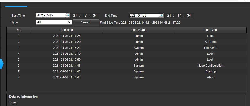

A relatively new IP8M-T2599E goes offline every few days for no apparent reason.
Works fine for days then goes offline seemingly at random, and isnt visible to the NVR, web interface or the IP Config utility.
Occasionally it will wake up long enough to send a frozen image to the NVR.
The camera is getting power even when offline, as indicated by the working IR illuminatiors.
I have replaced RJ45 connectors at each end, and then the entire solid copper cable without any improvement.
Changing its position on the PoE switch doesnt seem to matter, and Im within the power budget of the switch (if im understanding the power draw of the camera correctly).
Rebooting the camera by unplugging and reconnecting seems to bring it back to life for a couple days, then the cycle repeats.
Doesnt seem to be any particular time of day that this happens.
The only information that appears to be in the log is the last reboot (attached).
