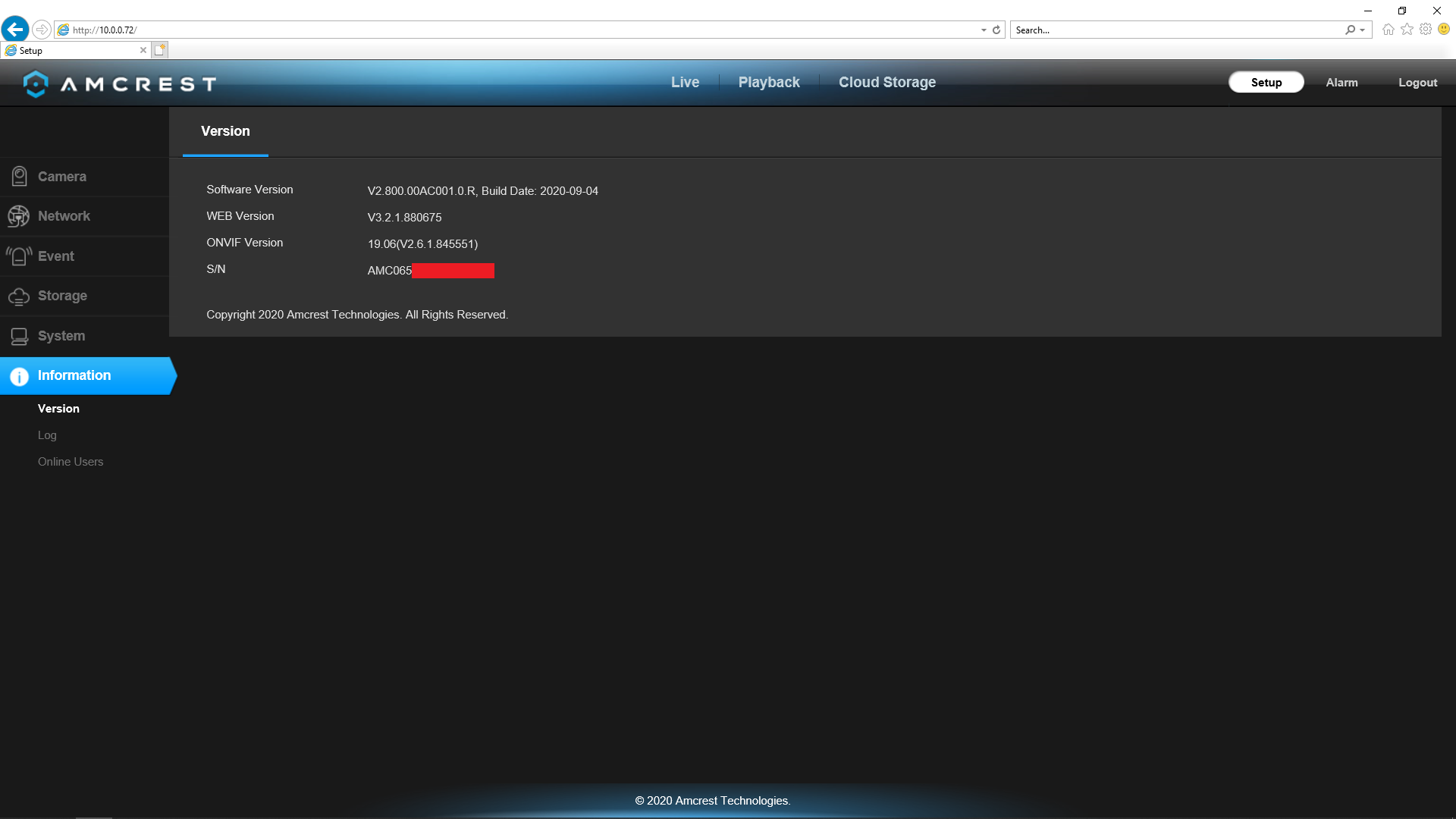

What is the easiest way to see what FW version I have? (Ideally using AVP otherwise I’ll have to check tomorrow)

About the FW it is best found on the WebUI of the camera. Picture below is a different camera but gives you an idea of where to look.. Log in then click Setup, then on left click Information, Version and there you can find all your FW..
Screenshot (2229).png (143.7 KiB) Viewed 1162 times
