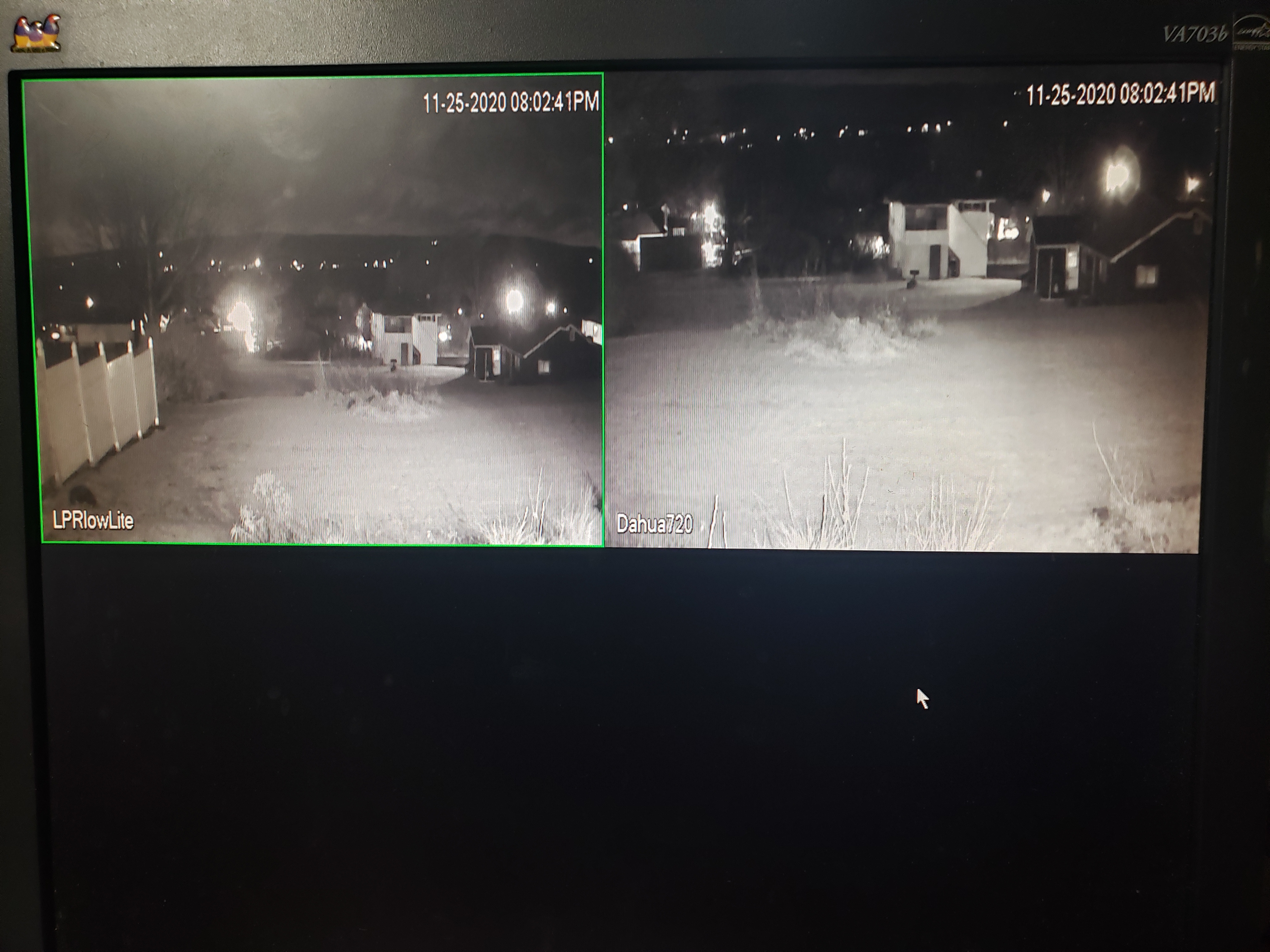

Well there are many things on the Plus side with many different things... To be honest it can be for whom could use the camera in it's current state.. While I do have other cameras Last night I took a Picture of one of my system with same Camera side by side.. The only thing is one of them I took the camera from a different style camera and added into the camera housing so I could have 1 with 2.8mm and they normally have a 5mm.. So I wanted to show you what it would look like and while it isn't a 4mm it does give you a little better of an idea.. Mind you these are 720p camera so quality isn't going to be upto par with a 4k camera but again is to give you an idea of what a difference it can make.. These cameras are 10' apart facing same area of view..
Don't mind the names I removed a camera and put in another one this isn't a IP camera or NVR so name changes have to be made and I just wanted to get the picture taken so this was on my Normal channel that I have a LPR with low LIght sorry not to confuse.. These 2 are both Dahua 720p IR cameras

By the way for better view if you right click and view in another tab then you can blow up to the large size sadly I didn't size it down before adding.. Also this is not a screen shot but a picture taken from my Samsung S9..
Sorry picture quality isn't the best just wanted to give an idea of 2.8mm on the left and 5mm on the right cameras are 10 feet apart
