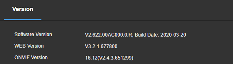

I am using 50 cameras of IP8M-T2499E Poe Camera installed firmware version V2.622.00AC000.0.R.
Randomly cameras stops working and doesn't respond when open thru browser though getting reply when Ping. Camera start when Need when unplug lan poe supply and then plug it back.
All the cameras are running 24x7 and this problem occurs once in 2 months.
Kindly look into this serious bug and resolve the same at the earliest.

- Screenshot 2021-04-26 at 4.35.14 PM.png (57.22 KiB) Viewed 690 times
