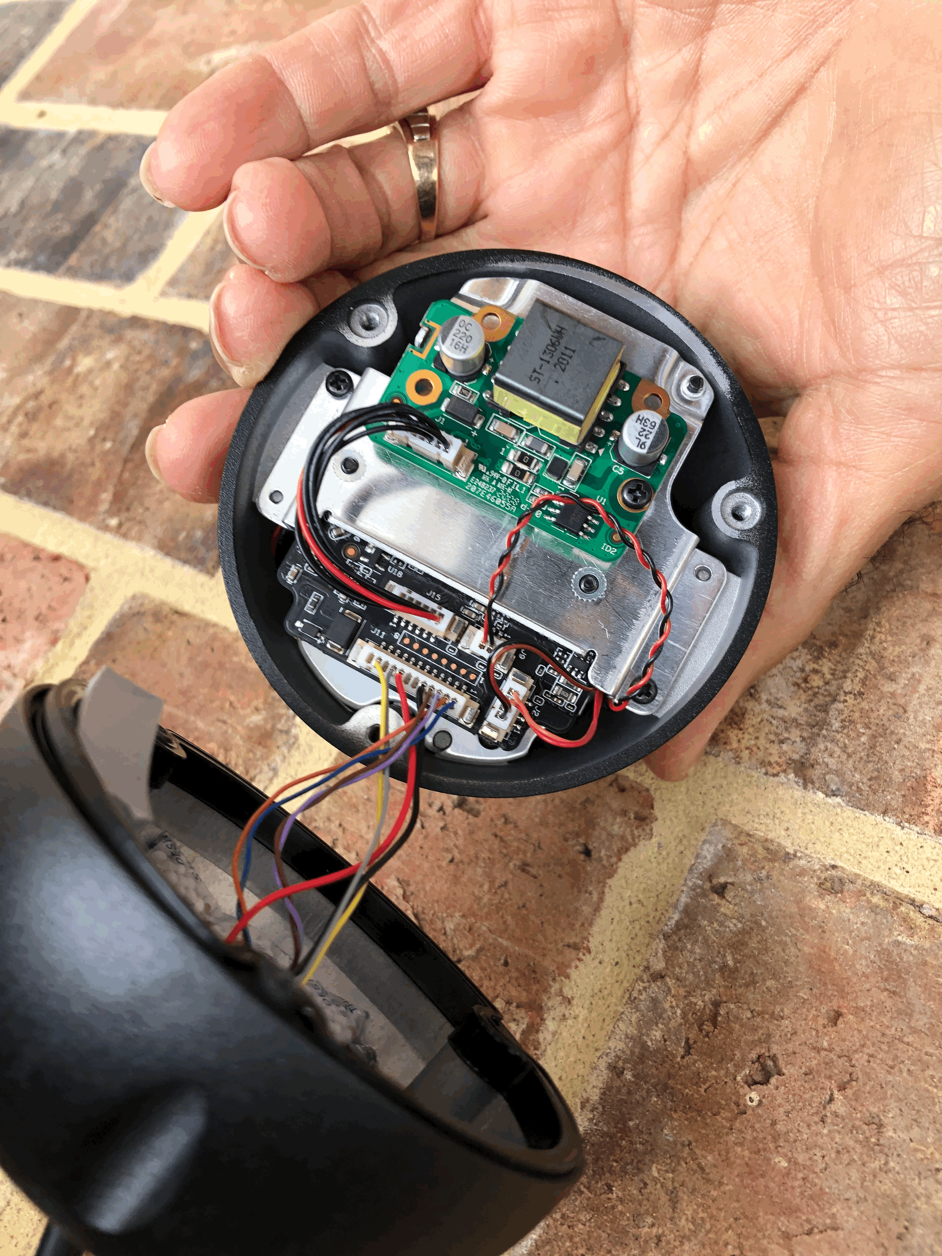

Got camera open but cannot find reset button Please help.

Sadly your not there yet.. you will need to take out the camera from the housing.. That will reveal the reset switch seeing it is so far into this camera it would have made since to add two wires and external switch but guess that wasn't thought of at the time with hope it will be released in newer models sadly for this one the camera has to be removed from the front of the housing..
Re: IP8M-T2499 How to do Factory Reset
A Friend of mine has the camera and he said that one of his cameras is like your a PITA to get to the switch the first time.. However after looking at your picture he explained to me that your camera is like one of his where the switch normally might need the camera removed like I said however if it is like his first one that he has had the longest it is by the Screw hole next to your ring in the picture of yours. He has another one that the Switch is in view when he opens the camera up but like yours if you don't want to take out the camera look under the Power Supply board to the Camera mother board next to the screw hole close to the top of the case it will be facing the screw hole. 25 to 30 seconds is what he said it takes to get it to Reset you will know because the IRC will click and that is a sound that you can't miss..
Hope you get/got the Reset done you needed..
