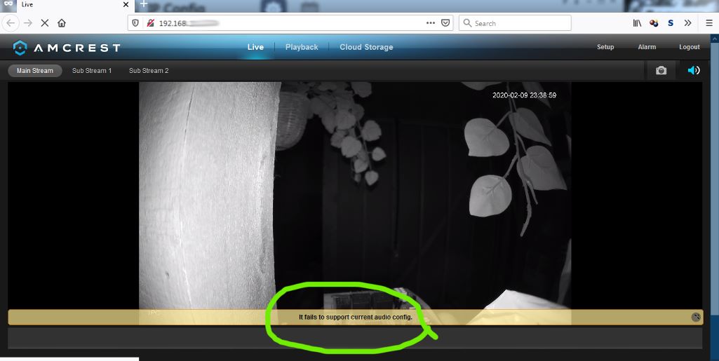

IP8M-MT2544EW "It fails to support current audio config"

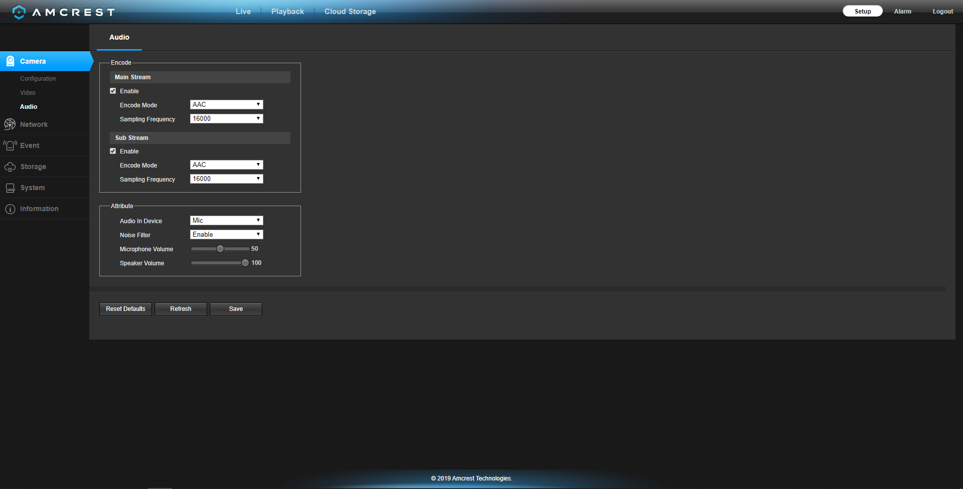

Don't know. That is what mine says I get audio on my NVR? Over the web and Mobile App?
Re: IP8M-MT2544EW "It fails to support current audio config"
I guess How are you trying to hear your Audio? Your only says it Fails to Support Current Audio? Then your Comment was Any Clues? Sadly I don't know what your Asking!!!! my Comment was that it works for me.. Mine didn't Fail? I guess my Question is then How did yours fail?

Revo2Maxx wrote: ↑Sat Feb 08, 2020 11:12 pm I guess How are you trying to hear your Audio? Your only says it Fails to Support Current Audio? Then your Comment was Any Clues? Sadly I don't know what your Asking!!!! my Comment was that it works for me.. Mine didn't Fail? I guess my Question is then How did yours fail?
You have 1 Way audio.. audio IN!

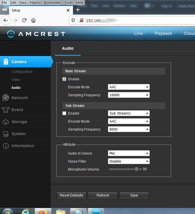

Glad that your audio works, but yours looks like a completely different camera than what I am asking about.
I posted the current audio configuration of my camera because thats what the error message referenced, and Im hoping someone familiar with that model might see something im missing and suggest a course of action to correct the error.

EDIT: Also Before you read this and Bore your self to death.. For Kicks I seen your Sub Stream1 setting was not Enabled for Audio... Before reading any more of this.. Click to enable the Sub to be sure both are online... try your method of hearing AUDIO if not working yet then read... End Edit

I may have made the assumption that someone would recognize the "It fails to support current audio config" phrase, if it were a known issue.
Revo2Maxx wrote: ↑Sun Feb 09, 2020 10:29 pm EDIT: Also Before you read this and Bore your self to death.. For Kicks I seen your Sub Stream1 setting was not Enabled for Audio... Before reading any more of this.. Click to enable the Sub to be sure both are online... try your method of hearing AUDIO if not working yet then read... End Edit

Thank you... Sorry don't know what viewer your using it might be that your current viewer isn't supported...

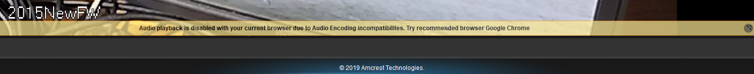

Only time I get that error is when i am using IE or another Non Chrome Viewer trying to listen to audio is why I said such
Thanks. FWIW I do get audio from the camera via the HDMI output so the onus is apparently on browser performance.
