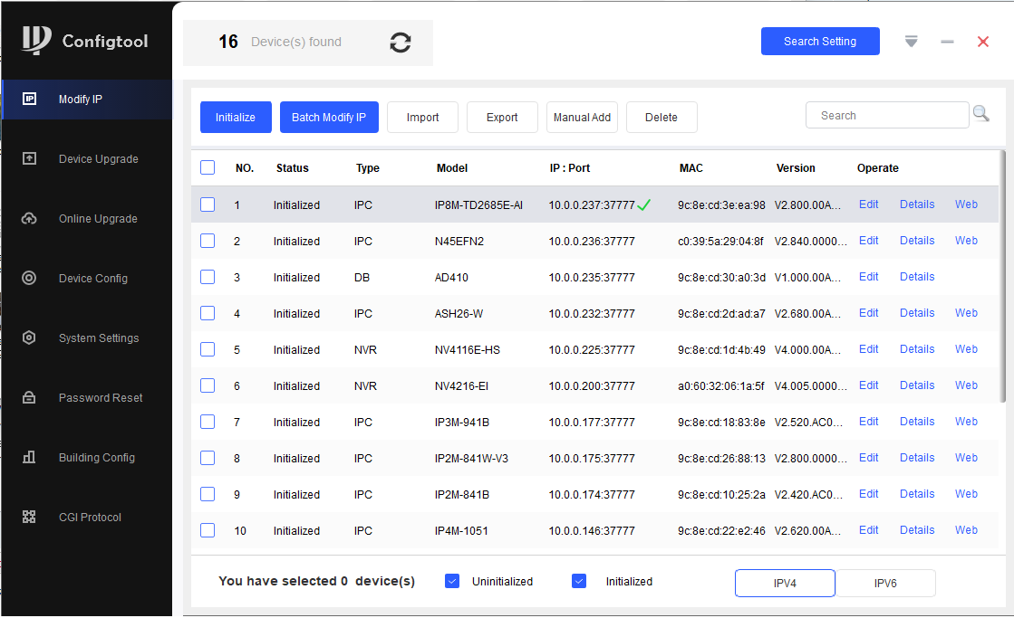

No go with Dahua, was able to select in that application DHCP within its own program but rebooting by disconnecting ethernet or select manual reboot within Dahus did not reset ip address or allow router to assign a new one, defaulted right back to static original.
I guess next step is try manual reset and see if camera actually performs the action.
Re: IP8M-DT3949EW-3AI lost App connection

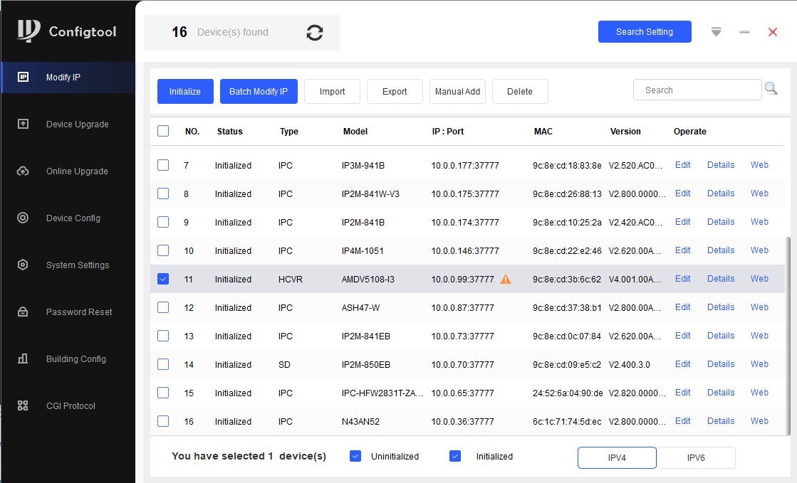

Wait in the app where you put in the data or change to DHCP there should be an OK at the bottom and when you press OK it should give a Check mark or a Triangle. You want the Green Check mark.. If it is Triangle then it failed.. IF fails you will want to make sure that you click the top button Search Setting. In there enter the correct password for your camera. Then try again. Again if it works you will nto need to reboot camera it will give a check and you can access with new IP addresses within a few seconds to like 30 at most.. Second picture is of 8ch DVR with different password you can see that it fails..
