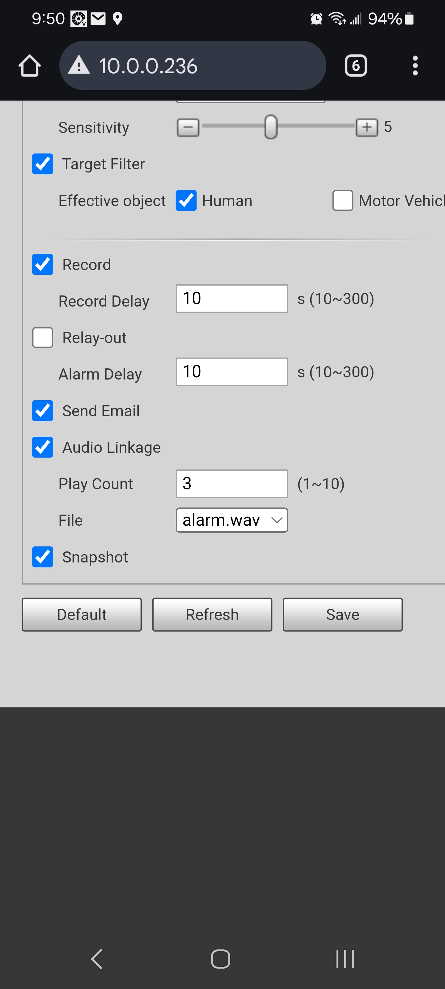

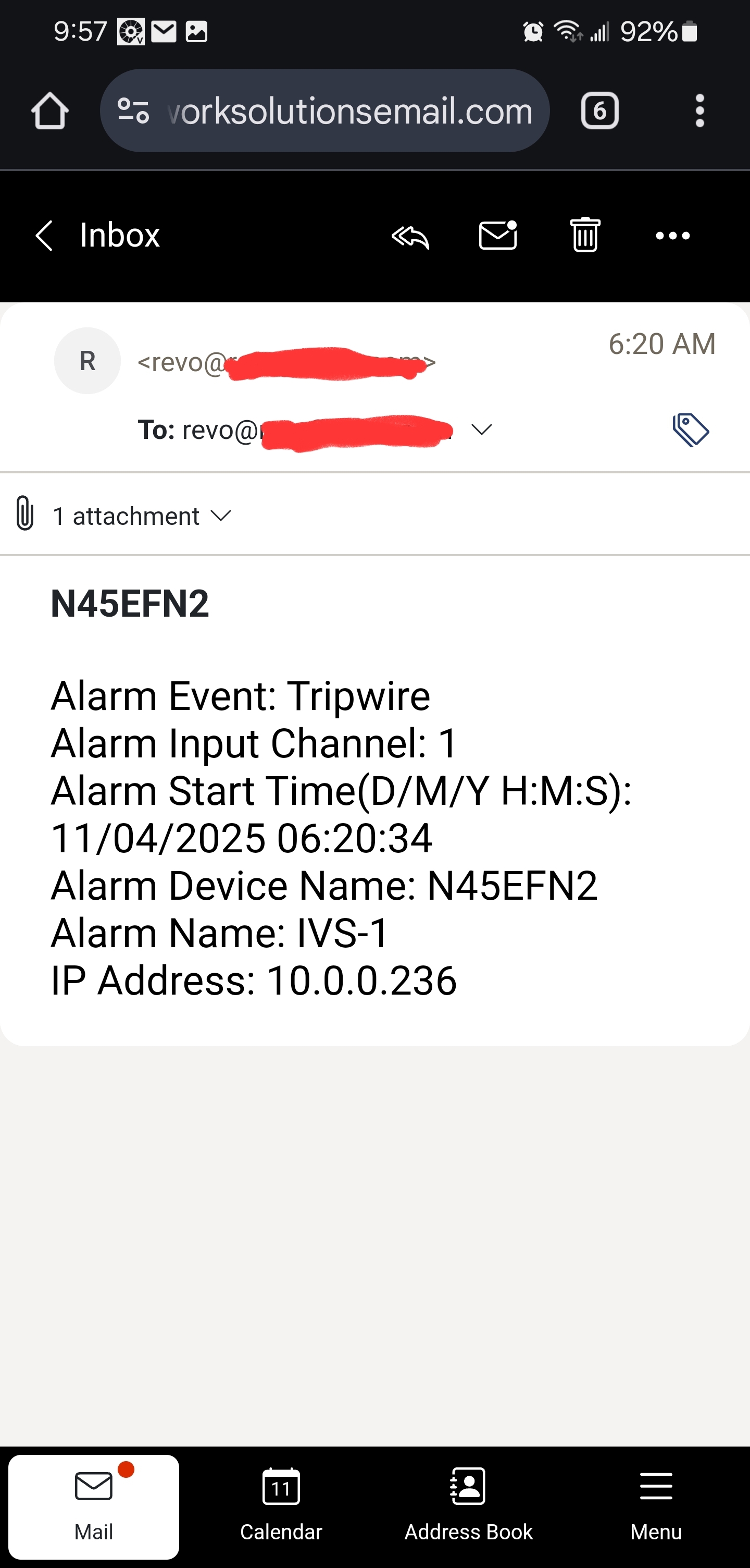

Ok in event area need to make sure snapshot is enabled if the option is there, might even ask 1,3 or 5 snapshots per event. Yet normally in ivs option is 1. Then will want to make sure in storage area under Schedule you have it setup under snapshot tab as motion and event and remove full time I would also make sure motion and event is also setup for normal recording as well. Added a snapshot of my email, you can see it has an attachment
