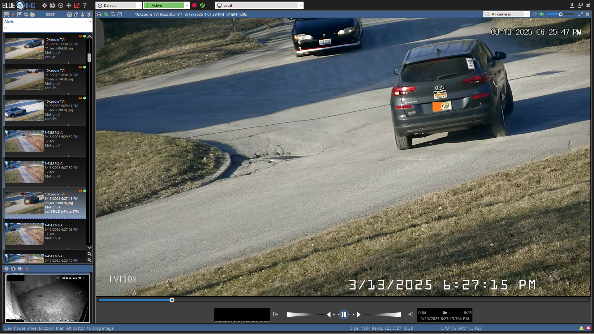

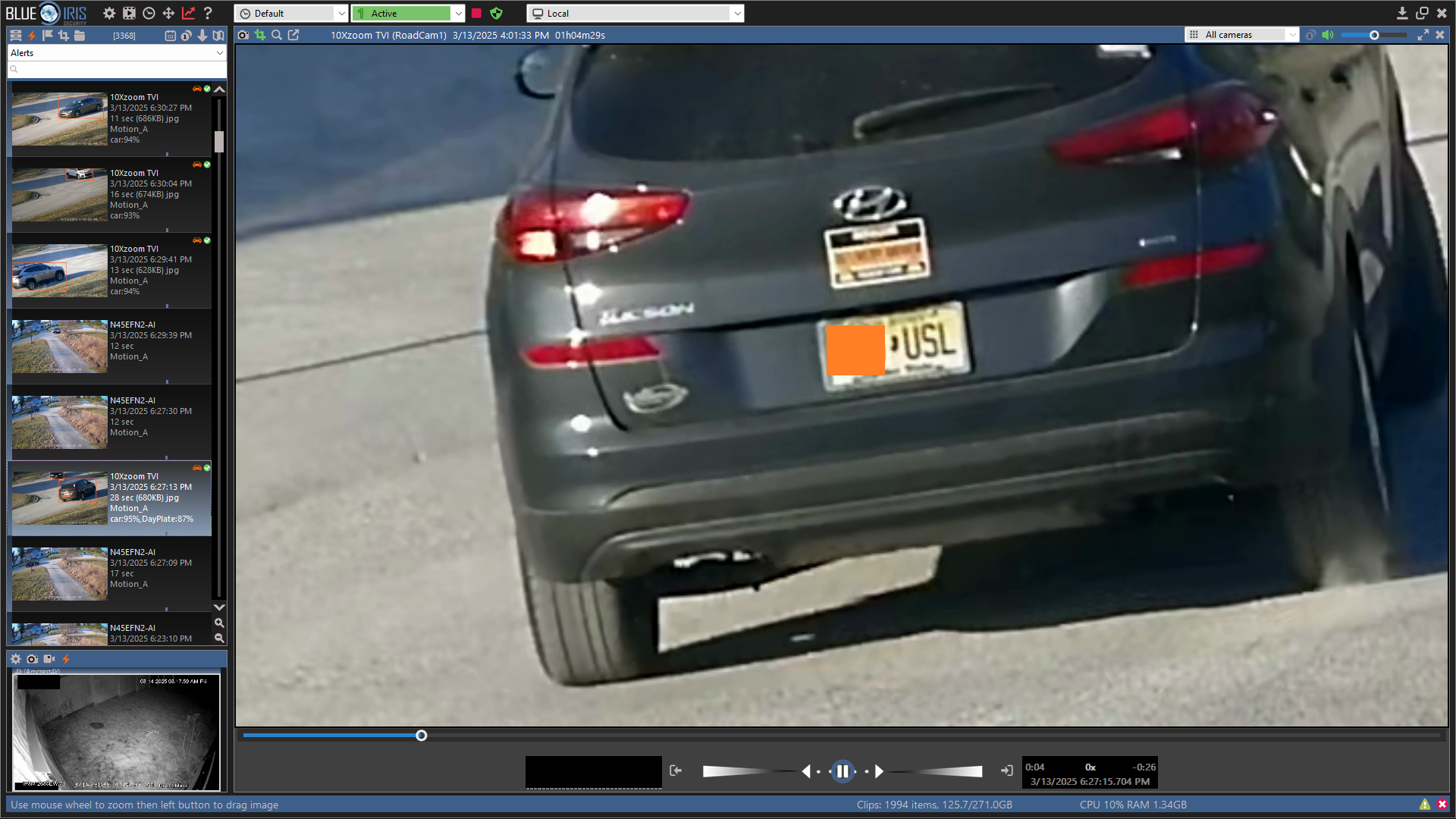

So don't get me wrong you can setup your camera with day/night profiles. it comes out of the box with Day setup for full time in auto format for changing over to B/W at night but is on day format.. Now main issue with PTZ cameras is that settings you want setup at night seem to have issues staying in PTZ cameras. Not all of them just most of them so people don't use PTZ cameras to capture plates most times.. As you can see from my 2mp TVI 10x zoom camera that I have setup on my Amcrest Ai DVR also setup on my Amcrest Ai NVR using my Amcrest DVR as an IP camera.. Anyway I also have it connected to my Blue Iris and the main function is to get full color events and plates when I can.. In the pictures below you can see that the camera is also setup on a Manual Focus point . This is the point where I have set it so any plate that is within 22 frames there should be one that the camera can read that is 22 frames within 1 second aka 22fps..
Problem is with PTZ cameras settings to hold things are not as easy to do as it is on a static Zoom cameras.. Now you could maybe setup a day profile for your camera to work in auto, and the night profile to work with modified focus and shutter that would again need to be very dark and the camera would not be able to see anything other then plates.. That is because the camera would need to make it so dark that the lights reflecting off the plate only returns the plate number and not just a blurry plate area..
Anyway again with a Static Zoom camera you can send a command that puts the camera at a set point for focus and no longer in auto focus.. Main issue with PTZ camera is that it was designed to pan and tilt and make changes to the current settings be it day or night but normally that don't include to being setting to fast shutter of like 1/1500 that would be able to return a plate and reject the lights from brakes or headlights.. Plus the camera has to be able to capture cars going 30-50 and again why a static zoom camera is better choice..
