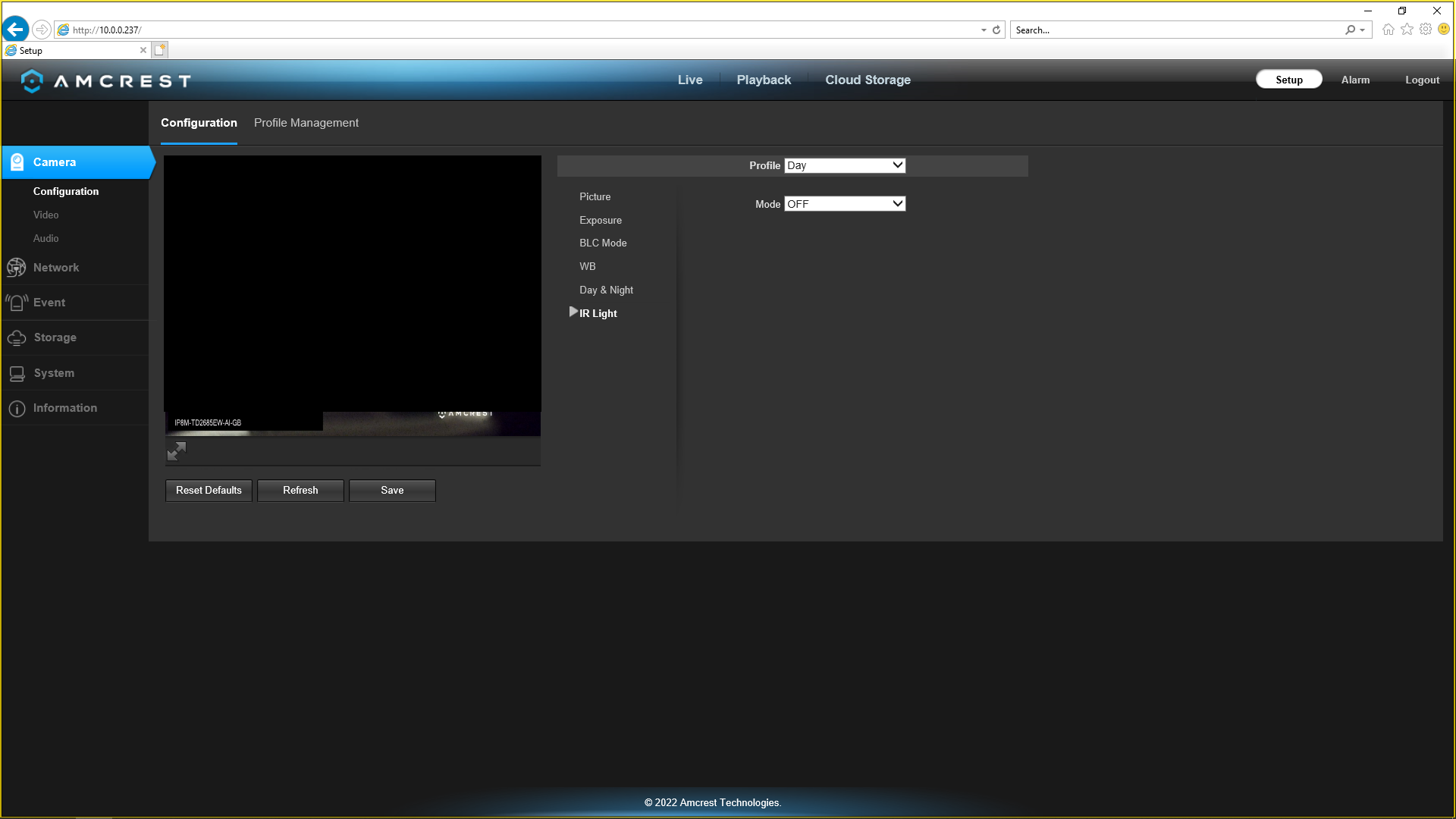

I tried all three profiles to off, and all thee options reverted to auto after a test logout.

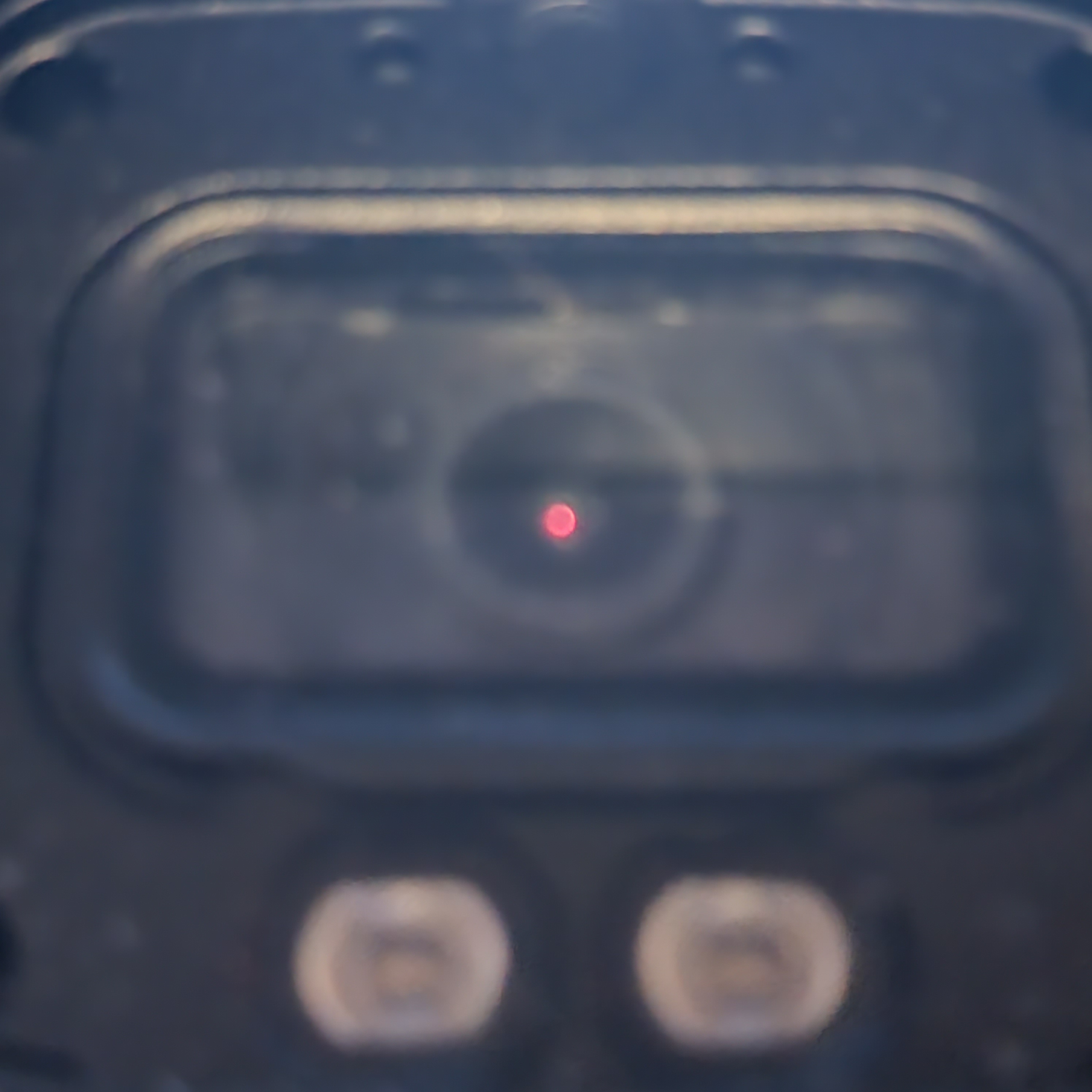

Though where is the light physically? I'm wondering if I can slip a chunk of electrical tape into the hide and cover the IR illuminator.

I am not sure of the camera you own. I mean if it is the one in your Header of the thread then the IR and White LED are both on the bottom of the camera and can be seen or at least that is what the picture of it looking like. The LED looks like it is setup same as my IP8M-TD2685EW-AI turret camera I just bought this month.

I can't see the illuminator , but it might be somewhere in the black glass, or worse in the lens area.

Ok sorry I am a little confused. The camera I find when looked up is showing a new style AI with 1 white and 1 ir led? So in your camera it will be hard to cover the leds because it is infact behind the black area. My guess is that it will be located at the bottom seeing it isn't a zoom camera that might have 4 where yours will have 2 that are center point of the bottom below the lens.
Sorry when I looked up your camera it comes up with
https://amcrest.com/4k-poe-camera-bulle ... ew-ai.html
My guess is that the IR would look like this. This is from my Amcrest IP8M-2496EW-V2 that is behind the tapped on plastic front.

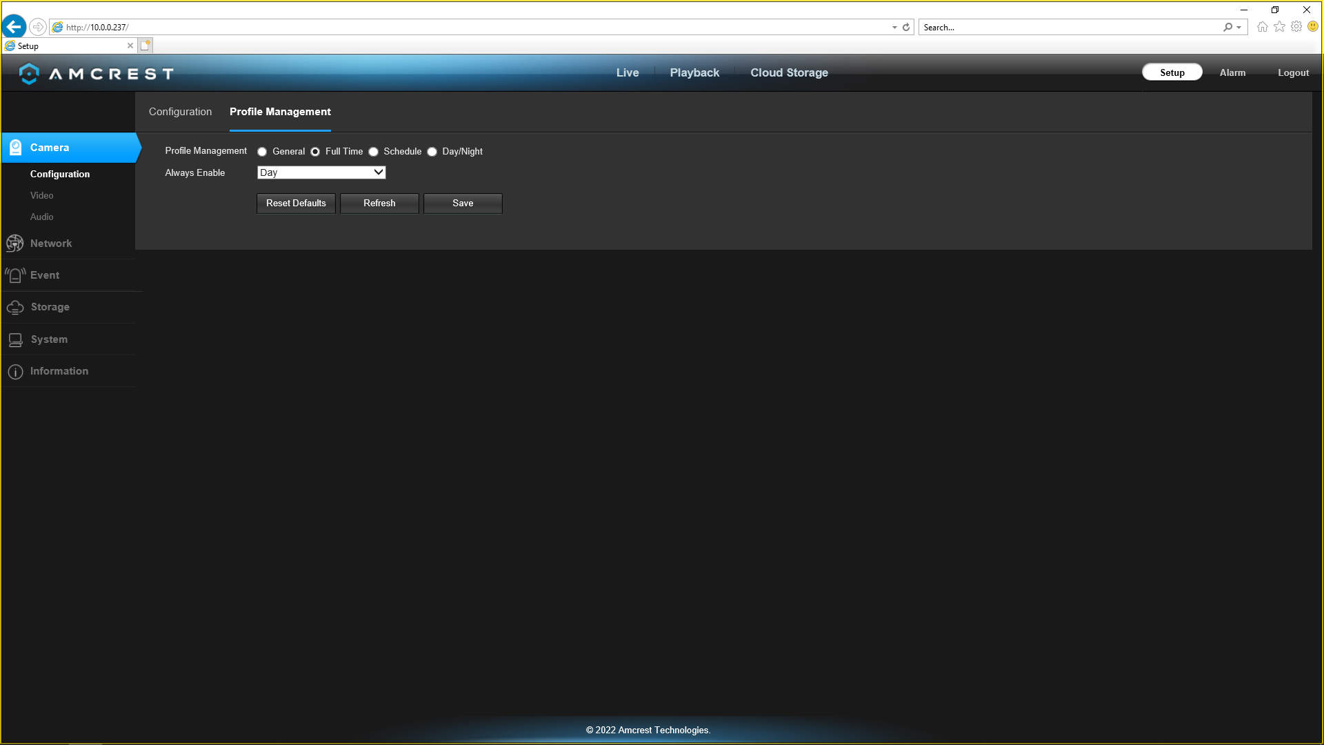

Well for my Camera the Lighting[0[ [3] .Mode=Off would be related to the General/Normal profile. So I would make sure that you are using that profile rather then using the Day or Night profiles.
Normally the cameras come setup out of the box with Full time Day set. So I would double check that your CGI has been set for all profiles if you want to make sure that it don't default back to a day and or night time setting.

Re: IP8M-2796E Won't leave the IR illuminator off.
I have the system set to cycle through all the options if it doesn't clear up. from [0][3] down to [0][0] but I figured the high number was an easier clue that the lower numbers exist.
But thankfully the General mode doesn't seem as fickle as the IR setting, so the code hasn't had to test lower indices.
