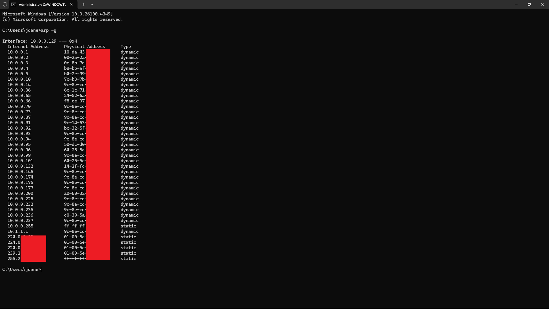

So from your computer is an Idea.. Bring up the terminal or dos prompt, On Win10/11 press Windows Key and R together then type in box cmd, then at the dos prompt type arp -g and see if your cameras and NVR come up..

IN the pictures below, I have a few cameras that are connected to 3 switches 1 in my Shed POE switch, one in my garage passes those cameras to the main switch in my house where I setup Vlans for other connected devices. My Arp as you can see they are all on 10.0.0.xx besides one of my POE NVRs does show the switch IP 10.1.1.1 but don't matter for this.. All of these cameras are connected to NVRs in my home.
Above I mention changing your camera Lan cable for your computers lan cable. Looking to see if the issue is maybe a vlan or something not working on its current connected port.. Can you log into your NVRs WebUI? Wifi camera from your computer can you log into the Cameas WebUI?

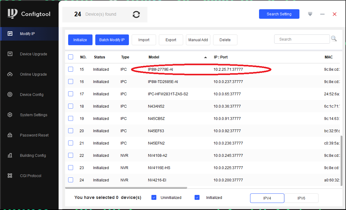

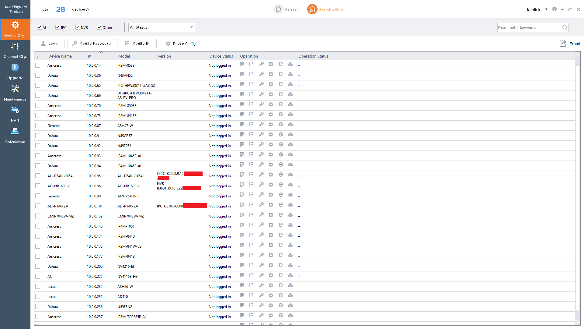

So as of now maybe to understand better what is going on. Download the Dahua IP Camera Tools and do a search of your network for your cameras. As you can see in the picture below I have moved one of my cameras that I have connected going to my 4116E-HS I know my other post said 4108E-HS that is on 10.0.0.218 IP and has the switch setup on 10.2.18.xxx and the cameras connected to the POE ports would reflect that IP address setup.. Anyway took my 2779E-AI camera that you are working with and moved it to one of my POE ports on my Lan Switch. As you see with Static IP setup that camera still has the IP of the switch and not my Local Lan. So that camera will now no longer show on the NVR because the front and back sides don't talk aka the local lan and the NVRs Switch Lan.. Anyway if you Download the Dahua Ip Camera tool and do a search and post a picture of your cameras it might show something that was missed and might bring light to why it isn't working?
