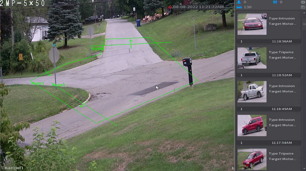

So in my Picture below, this is on my DVR that I have the ability to use SMD. 1 I don't normally for this channel because if you look in the picture you can see the list of all the cars that pass and I can click that for a fast playback if I wanted.. Now in my picture I have my system setup little different then as I was talking for you. That is because I have 2 Tripwires that I want to trigger my Amcrest 850EB to a Preset once a Vehicle passes. I have the Intrusion box setup for both Human and Vehicles and the Tripwires for only Vehicles and it works perfect as expected..

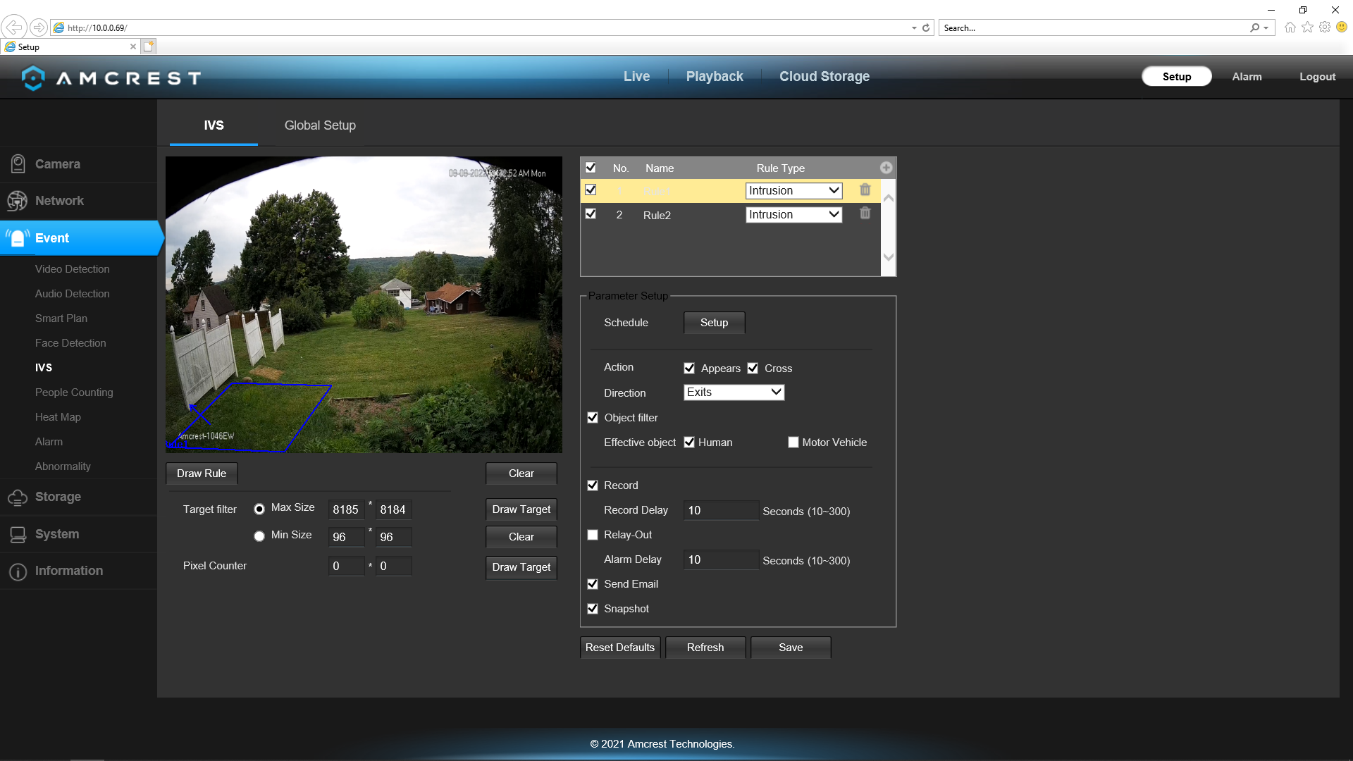

So then for your setup. You said you want your setup to detect both Vehicle and Humans but also detect all other normal motions under SMD that won't happen. That is if it was working with AI detection enabled using Object Filter. Now my 1046EW-AI don't offer SMD but in the Second picture you can see for my IVS Rules I have the Human detection turned on. however because this is IVS if I wanted and I don't because of Spiders, other bugs, and little animals was setting off my camera so I use IVS pure only with Object Filter turned on. I have other cameras that don't offer Object filter and always false alarms with Spiders, bugs and birds going though my Intrusion lines...
Anyway the 1046EW-AI i have setup with Intrusion in 2 different boxes only showing the first rule seeing they show only 1 at a time however because of the area I have 2 PTZ's that when a Human enters 1 box and exits the first it will tell one of my PTZ cameras to go to a Preset once the event time is up that camera returns back to its guard position. If I didn't have it setup for humans then every thing that set off the event would have my PTZ camera working hard. I know if I look at my screen and one of them cameras are looking in the preset of that Rule then I know to look because something really triggered it..
Now with all that said. Using IVS, I can also leave my Motion enabled to get motion events however I disable motion and only use IVS with Object filter turned on...
