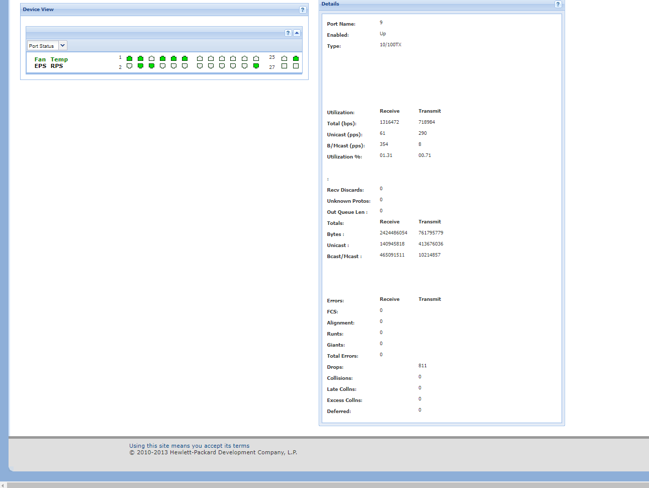

This could also be an issue with your Network cabling... Ensure that your cables are True TIA/EIA UL listed cables and not some CCA cables that are only keeping your camera running on borrowed time... Sadly most cases when CCA cables fail it will take or could take and destroy the device it is powering and worse yet for some the POE Switch...One of my IP cameras is over 1400 USD and is POE+ powered if I don't put it on a good cable it can cause issues...
Most times Shutter speed can be a Motion Blur factor however so can network connection issues.. If you have a Managed Switch look at the Port and I am going to guess it will have loads of Errors for send and recv packets... Even might have some Pauses
Edit: Adding a Picture of one of my Switches that has 811 drops to one of my Routers that it powers over POE... The drops are because the Router is a outdoor router that is connected with one of my Cameras over distance and when it is expecting a from the camera but camera fails it drops the packet This is only one that has any type of Errors on my network but you can see in this Switch there errors area that I was referring to.. Might help you find out if yours is managed if you have issues looking at Port Data...
Screenshot (1629).png (37.09 KiB) Viewed 778 times
