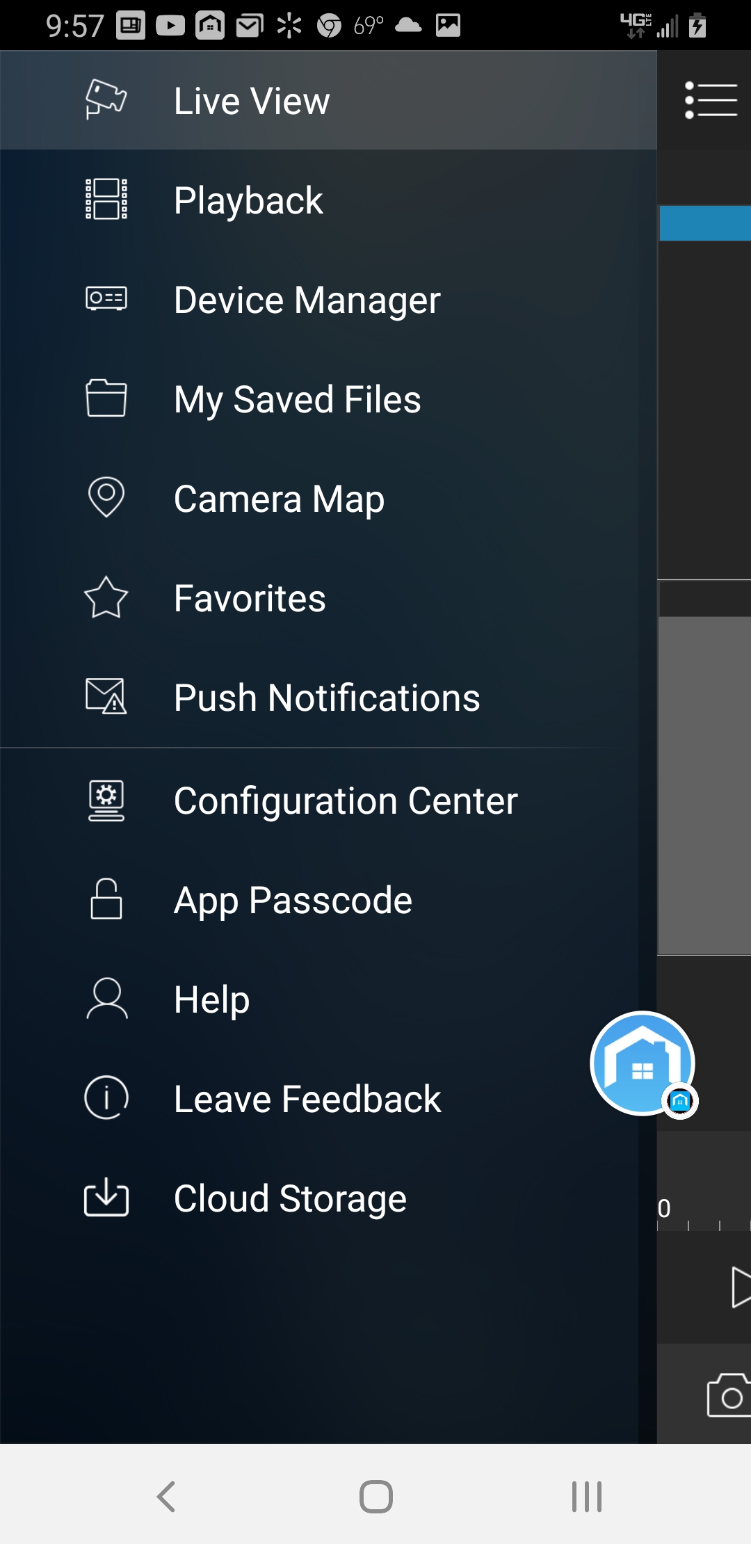

Where is the setting for push notifications?
Re: IP8M-2597 event email issue
When you are on your CELL phone app Amcrest View Pro that you can DL for free off the Google Store or Apple Store. Then when your looking at the page with your device there is a button at the top of the app on the left 3 dots and 3 lines. Click that then click the Push Notifications
Screenshot_20210502-215749_Amcrest View Pro.jpg (362.42 KiB) Viewed 626 times
