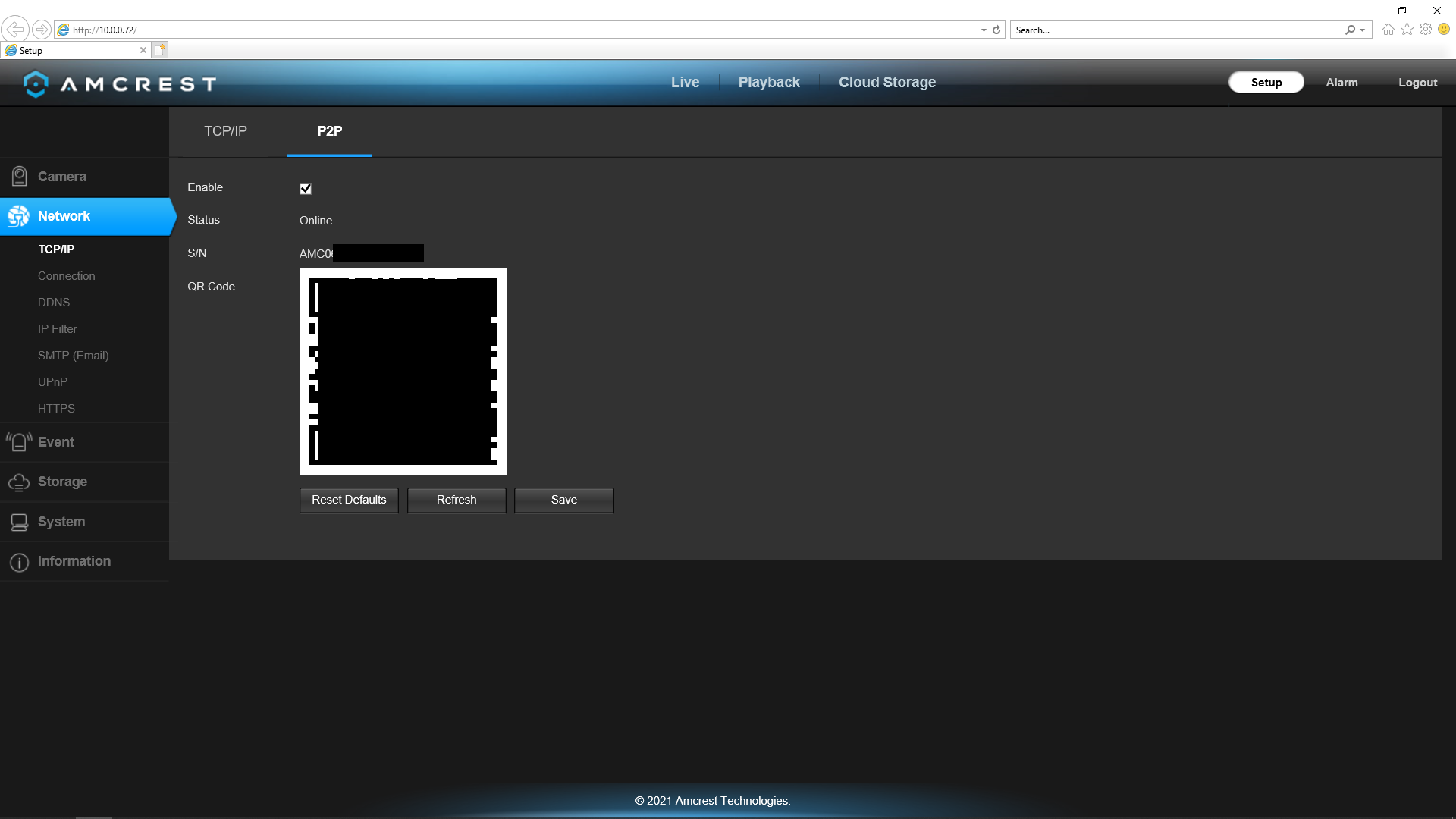

About other things that always reach out you will want to turn off P2P seeing you say you make a connection over VPN and that P2P will reach out a lot making sure to keep your access open for service 24/7. Log into the Cameras WebUI, Then Setup, Then Network, then TCP/IP. There will be 2 tabs in that window one will say P2P and look like picture below. Uncheck the Enable and save it will take 2 hours maybe more before the server and camera no longer reach out to one another that is normal.

Yes, this is the setting I was referring to when I said I had disabled cloud. The question was if there's any other settings to disable other unneeded communications.Revo2Maxx wrote: ↑Wed Jun 22, 2022 11:57 am About other things that always reach out you will want to turn off P2P seeing you say you make a connection over VPN and that P2P will reach out a lot making sure to keep your access open for service 24/7. Log into the Cameras WebUI, Then Setup, Then Network, then TCP/IP. There will be 2 tabs in that window one will say P2P and look like picture below. Uncheck the Enable and save it will take 2 hours maybe more before the server and camera no longer reach out to one another that is normal.
