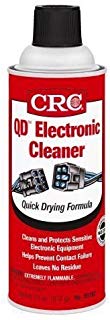

If the camera is out of warranty, then you might want to open the housing and clean the circuitry with an electronics cleaning spray such as CRC brand, available at many auto parts stores:
